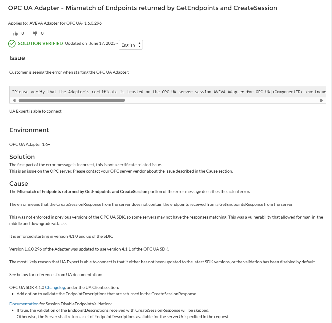

**Author:** ![Luke\_Reznecheck](https://avatars.discourse-cdn.com/v4/letter/l/b487fb/32.png) [@Luke\_Reznecheck](https://forum.inductiveautomation.com/u/Luke_Reznecheck)\
**Post date:** [August 18, 2025, 10:14pm UTC](https://forum.inductiveautomation.com/t/opc-ua-item-attribute-description/98879/6 "2025-08-18T22:14:38Z")
Thanks Cody,
Unfortunately, when I updated to v1.6 of the adapter, AVEVA also updated the OPC UA SDK version to the latest (4.1.0) which created a new issue.
[Knowledge](https://customers.osisoft.com/s/knowledgearticle?knowledgeArticleUrl=000052861)
 ![image](https://us1.discourse-cdn.com/inductiveautomation/original/3X/9/e/9e4981500ffe6182fddd32d468ee6c6174022698.png)
So, it looks like now the ball is back in Inductive’s court to resolve the mismatch of endpoints returned by GetEndpoints and CreateSession.

**Post date:** [August 18, 2025, 10:21pm UTC](https://forum.inductiveautomation.com/t/opc-ua-item-attribute-description/98879/7 "2025-08-18T22:21:46Z")
> [@Luke\_Reznecheck](#):
We've already received a Wireshark capture and punted this back to Aveva. Not sure if that was your ticket or if your capture would look the same. The ticket we received it on was getting the error even with security disabled, so we were able to see it clearly in Wireshark.

**Post date:** [August 19, 2025, 1:28am UTC](https://forum.inductiveautomation.com/t/opc-ua-item-attribute-description/98879/11 "2025-08-19T01:28:37Z")
> I don’t think it is security related. The error in the logs says security on Aveva’s end, but they said that is inaccurate and it is the mismatch between the endpoint name and session url? I think it may be related to the URN style paths. They didn’t support that before.
The logic their client uses to compare the endpoints from discovery vs the ones returned in the CreateSessionResponse incorrectly includes the certificate as part of the comparison, when it explicitly should not be included: [UA Part 4: Services - 5.7.2.2 Parameters](https://reference.opcfoundation.org/Core/Part4/v105/docs/5.7.2.2#:~:text=It%20is%20recommended%20that%20Servers%20only%20include%20the%20server.applicationUri%2C%20endpointUrl%2C%20securityMode%2C%20securityPolicyUri%2C%20userIdentityTokens%2C%20transportProfileUri%20and%20securityLevel%20with%20all%20other%20parameters%20set%20to%20null%20or%20empty.%20Only%20the%20recommended%20parameters%20shall%20be%20verified%20by%20the%20Client).
It's actually a bug in the SDK they use. It's a configurable check in the SDK that they could turn off until it's fixed. It looks like the KB even quotes the SDK docs that mention it.
