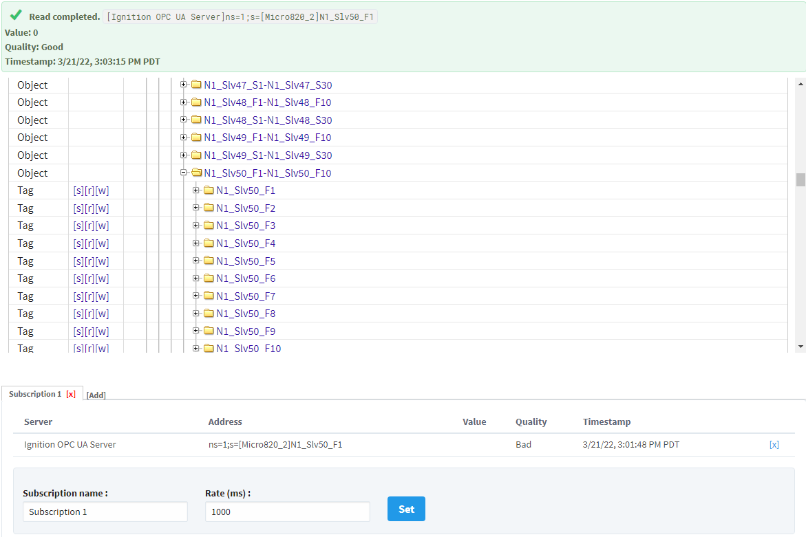

Hello i am having a problem,
i just add some tag for my modbus connection.
But quality is BAD,
what is unusual if i use OPC quick client, i can read the tag(see top of screenshot) but not suscribe (see lower par of screenshot).
i have many other tag on this same connection working fine.
but all what i need to add seems not working…
any idea what should i do ?
 ![bad quality tag](https://us1.discourse-cdn.com/inductiveautomation/original/3X/c/4/c47b3cd76c131de527efefc445bd560c3eae88c1.png)
**Post date:** [March 21, 2022, 3:24pm UTC](https://forum.inductiveautomation.com/t/opc-ua-modbus-bad-quality-tag/57419/2 "2022-03-21T15:24:43Z")
If you disable the “Span Gaps” advanced setting for that Modbus device in the Ignition Gateway does the subscribe for that tag start working?
**Author:** ![Antoine\_Rvl](https://avatars.discourse-cdn.com/v4/letter/a/8491ac/32.png) [@Antoine\_Rvl](https://forum.inductiveautomation.com/u/Antoine_Rvl)\
**Post date:** [March 23, 2022, 12:30pm UTC](https://forum.inductiveautomation.com/t/opc-ua-modbus-bad-quality-tag/57419/3 "2022-03-23T12:30:37Z")
Yes it solves the problem.
Thank you for quick answer.
