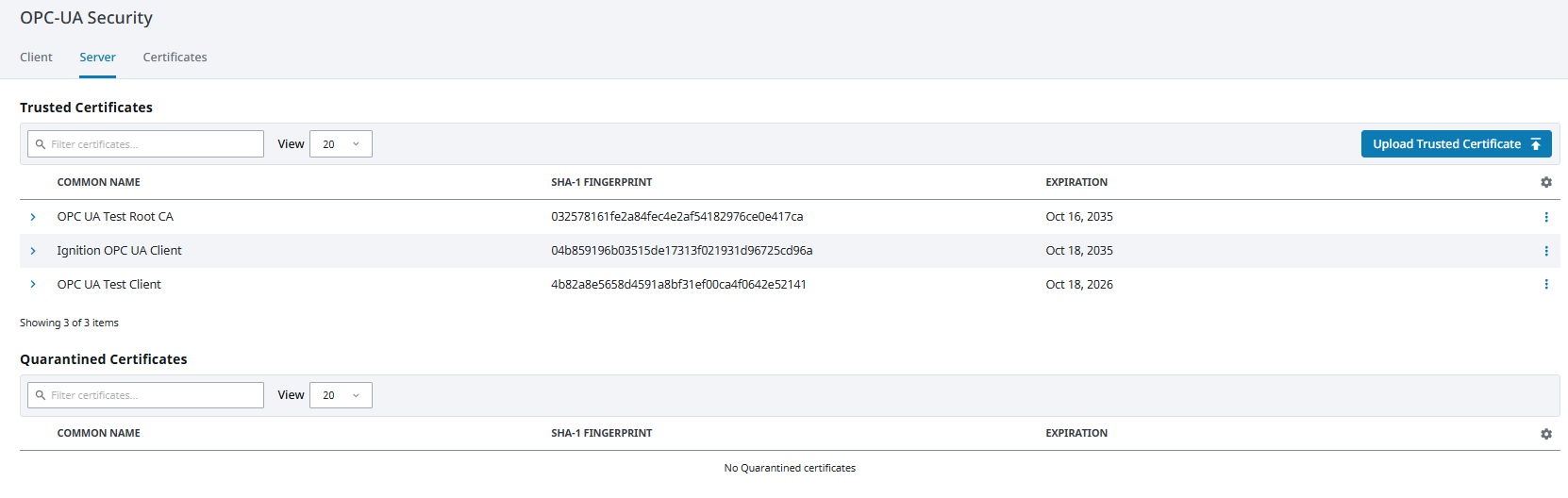

**## What Works**
✅ **\*\*Plain OPC UA connections\*\*** (no security) work perfectly
✅ **\*\*Certificate is trusted\*\*** - verified in Ignition Gateway \> Config \> OPC UA \> Server \> Security \> Certificates (shows as trusted)
✅ **\*\*Same certificate works\*\*** with other OPC UA servers (Prosys OPC UA Simulation Server) using identical security settings
✅ **\*\*Gateway services\*\*** are running properly
**## What Fails**
❌ **\*\*All secure connection attempts\*\*** fail with `BadSecurityChecksFailed`
❌ **\*\*Error occurs during secure channel establishment\*\*** (before authentication)
❌ **\*\*Multiple security modes tested\*\*** : Sign, SignAndEncrypt, different policies - all fail
❌ **\*\*Anonymous secure connections\*\*** also fail (not user authentication issue)
**## Detailed Testing Performed**
**### 1. Certificate Verification**
- Created CA and client certificates using OpenSSL
- Imported CA certificate into Ignition Gateway trusted certificates
- Verified certificate appears as "Trusted" in Gateway interface
- Certificate fingerprint matches exactly: `4b82a8e5658d4591a8bf31ef00ca4f0642e52141`

**Author:** ![alcalaf](https://avatars.discourse-cdn.com/v4/letter/a/7feea3/32.png) [@alcalaf](https://forum.inductiveautomation.com/u/alcalaf)\
**Post date:** [October 19, 2025, 1:36pm UTC](https://forum.inductiveautomation.com/t/opc-ua-secure-connections-fail-with-badsecuritychecksfailed-despite-trusted-certificate-plain-connections-work/111581/6 "2025-10-19T13:36:44Z")
[wrapper.log](https://forum.inductiveautomation.com/uploads/short-url/v54op23WISNiR4J1rggwmXvlazP.log) (372.3 KB). Thanks. See the log file, and see the analysis done by the LLM. What I found odd is that the certificate is being trusted as expected.
 ![image](https://us1.discourse-cdn.com/inductiveautomation/original/3X/0/4/0482b384e04c2144fa64a734f4740e148df4a376.png)
See the comparison test with Prosys (OPC Server Emulation)
**Post date:** [October 19, 2025, 1:44pm UTC](https://forum.inductiveautomation.com/t/opc-ua-secure-connections-fail-with-badsecuritychecksfailed-despite-trusted-certificate-plain-connections-work/111581/7 "2025-10-19T13:44:37Z")
> [@alcalaf](#):
> I try that recommendation the discovery process is working properly. However, the root issue is still the certificate validation during secure channel establishment.
**Post date:** [October 19, 2025, 8:23pm UTC](https://forum.inductiveautomation.com/t/opc-ua-secure-connections-fail-with-badsecuritychecksfailed-despite-trusted-certificate-plain-connections-work/111581/11 "2025-10-19T20:23:10Z")
Thanks,
I have both certificate in ignition. Still the same issue
 ![image](https://us1.discourse-cdn.com/inductiveautomation/original/3X/8/8/881afe97c08b29b6a210e1d00287d9b02869d2f8.png)

Your application instance certificate is missing required KeyUsage extensions.
It has Digital Signature and Key Encipherment, but is missing Non Repudiation and Data Encipherment.
See [UA Part 6: Mappings - 6.2.2 Application Instance Certificate](https://reference.opcfoundation.org/Core/Part6/v105/docs/6.2.2#:~:text=used.-,For%20RSA%20keys%2C%20the%20keyUsage%20shall%20include%20digitalSignature%2C%20nonRepudiation%2C%20keyEncipherment%20and%20dataEncipherment.,-For)
