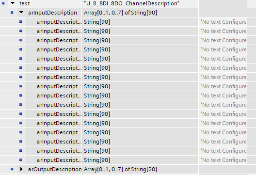

I am using OPC UA to read data from S7-1500 PLCs. I have some structures containing 2d-arrays, defined like this for example:
 ![image](https://us1.discourse-cdn.com/inductiveautomation/original/3X/8/4/84dfa85d409132656be03a701f732e748a784a87.png)

I've tested different things, and it seems like this is caused by 2d-arrays inside a structure.
I can address those 2d-arrays directly, and it works fine, except they become 1d.
Is that because Ignition does not support 2d-arrays in tags currently? What can be done so that Ignition won't stop decoding subsequent data in these structures?
Also, I can provide wireshark captures of data I am getting from the PLC if needed.
**Post date:** [July 17, 2023, 1:24pm UTC](https://forum.inductiveautomation.com/t/opcua-and-2d-arrays/76453/2 "2023-07-17T13:24:47Z")
> [@Artem\_Eremeev](#):
Correct.
I'm not sure there's a work-around.
**Post date:** [July 17, 2023, 1:41pm UTC](https://forum.inductiveautomation.com/t/opcua-and-2d-arrays/76453/3 "2023-07-17T13:41:33Z")
If you set the Ignition tag type to StringArray you might get a flattened/1d value.
But otherwise, yes, as Phil said, Ignition’s tag system does not support multi dimensional arrays.
