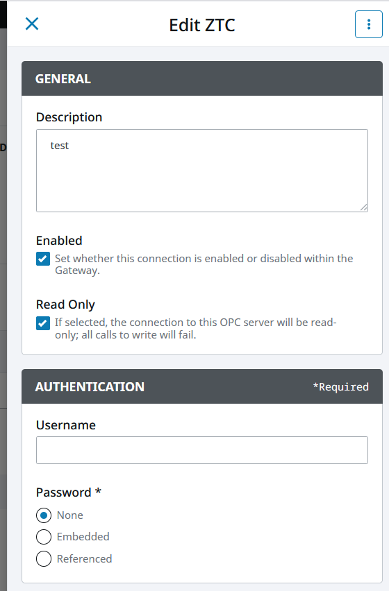

I have a Stratus ZTC Edge machine which has an OPCUA server to allow an OPC client to get status information about the machine and operating environment. I was able to connect and read the topics using Ignition 8.1. I am now trying to connect using an Ignition 8.3.1 system. I have disabled security and certificates for testing. I get the following error when trying to connect. Has anyone else seen this?
ava.lang.NullPointerException: Parameter specified as non-null is null: method com.inductiveautomation.ignition.gateway.secrets.SecretConfigKtx.getPlaintextString-gIAlu-s, parameter $this$getPlaintextString
at com.inductiveautomation.ignition.gateway.secrets.SecretConfigKtx.getPlaintextString-gIAlu-s(SecretConfigKtx.kt)

Can you post the full logs?
I think this means something is wrong with the OPC UA connection configuration... missing/empty password maybe?

Thanks for the response. The OPCUA Server is setup for anonymous connection since it is for inhouse testing.

**Post date:** [November 5, 2025, 7:48pm UTC](https://forum.inductiveautomation.com/t/opcua-connection-on-ignition-8-3-1-with-stratus-ztc-edge/111968/4 "2025-11-05T19:48:25Z")
Ok, it seems you may have modified the "Key Store Alias Password" field (advanced setting) to be empty.
By default, the "Key Store Alias" is "client" and the "Key Store Alias Password" should be "password". Most people will never need to change these.

**Post date:** [November 5, 2025, 8:35pm UTC](https://forum.inductiveautomation.com/t/opcua-connection-on-ignition-8-3-1-with-stratus-ztc-edge/111968/5 "2025-11-05T20:35:34Z")
Kevin,
Thanks, That fixed it.

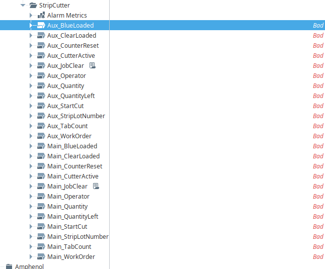

I ran through this to fix the connection on one of my OPC-UA servers, and it was successful. But this forces me to re-create my tags. when I point my tags at the new location, I am getting nothing but bad tags. Without having the OPC client anymore (huge groan) I don’t really have a way of reading this to test it. Any thoughts or help please?
 ![image](https://us1.discourse-cdn.com/inductiveautomation/original/3X/b/4/b4de116ff927761849cc68c298136b5b7aab75a8.png)
**Post date:** [November 24, 2025, 4:44pm UTC](https://forum.inductiveautomation.com/t/opcua-connection-on-ignition-8-3-1-with-stratus-ztc-edge/111968/8 "2025-11-24T16:44:56Z")
> [@ntheuer](#):
Why do you need to create new tags?
**Author:** ![ntheuer](https://avatars.discourse-cdn.com/v4/letter/n/ccd318/32.png) [@ntheuer](https://forum.inductiveautomation.com/u/ntheuer)\
**Post date:** [November 24, 2025, 4:56pm UTC](https://forum.inductiveautomation.com/t/opcua-connection-on-ignition-8-3-1-with-stratus-ztc-edge/111968/9 "2025-11-24T16:56:55Z")
something about red lion when I restart the OPC-UA server it changes the item path and I have to re-point it at the correct one
![image](https://us1.discourse-cdn.com/inductiveautomation/optimized/3X/3/9/394f5049161ed52761a86bb1a2e8864c06cbab4e_2_690x35.png)
I can see all my tags here, but no matter what option I’ve tried the parent option and all the child options (as text label, name, etc) but they all return ‘bad’
 ![image](https://us1.discourse-cdn.com/inductiveautomation/original/3X/7/3/730e6aba1ef83aa7c14faa0f80df2d20962eac8a.png)
**Post date:** [November 24, 2025, 4:58pm UTC](https://forum.inductiveautomation.com/t/opcua-connection-on-ignition-8-3-1-with-stratus-ztc-edge/111968/10 "2025-11-24T16:58:17Z")
If the RedLion OPC UA server changes its NodeIds on each reboot then it is plainly broken and you need to contact them for support.
I'm not sure how this connects to what this thread was originally about.
