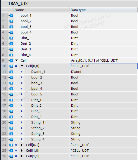

UDT tags structure: When 2/3 demsion array struct under another struct.

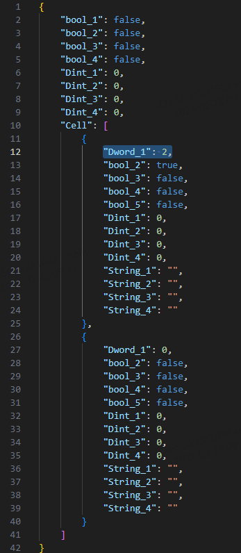

Problem: I got two results randomly, bad quality with "Bad\_DecodingError", or readout the json string with something wrong in data and format. Here example I suppose to got 4 elements in 'CELL' struct, which I only got two, and some strange data in first element that is different than PLC data.

Just got some information from Siemens that changes in new firmware is adhering the OPC UA specification V1.04.
- " multi-dimensional arrays are now encoded as an Int32 Array containing the dimensions followed by a list of all the values in the array."
So the question is, would it be possible from ingnition to support new opc ua spec in future updates?
