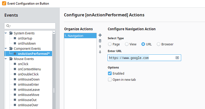

Or the `navigation` thingie that seems to be built for exactly that:

my script will have to retrieve the link of the website in the database
**Author:** ![pascal.fragnoud](https://sea1.discourse-cdn.com/inductiveautomation/user_avatar/forum.inductiveautomation.com/pascal.fragnoud/32/24728_2.png) [@pascal.fragnoud](https://forum.inductiveautomation.com/u/pascal.fragnoud)\
**Post date:** [May 12, 2022, 1:31pm UTC](https://forum.inductiveautomation.com/t/open-a-website-on-ignition-perspespective-using-a-button/59499/6 "2022-05-12T13:31:56Z")
Based on what ?
You could bind a custom prop to the query, then use that custom prop in the panel I showed above.
**Post date:** [May 12, 2022, 1:32pm UTC](https://forum.inductiveautomation.com/t/open-a-website-on-ignition-perspespective-using-a-button/59499/7 "2022-05-12T13:32:17Z")
Use Brian’s answer. You can’t use local java operations (like BrowserLauncher) to cause actions in a Perspective session. Only Vision can do that.

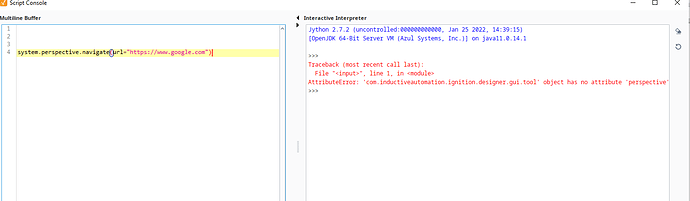

I tryied but this method don’t work

**Post date:** [May 12, 2022, 1:37pm UTC](https://forum.inductiveautomation.com/t/open-a-website-on-ignition-perspespective-using-a-button/59499/9 "2022-05-12T13:37:40Z")
Of course that won’t work in the script console–the script console is not a Perspective scope. Put that in a script action on a Perspective pushbutton. (Or wherever.)
Let me repeat: The designer’s script console is a _ **terrible** _ tool for testing scripts for Perspective. _ **Don’t use it for Perspective.** _
**Author:** ![sebastien\_ng](https://sea1.discourse-cdn.com/inductiveautomation/user_avatar/forum.inductiveautomation.com/sebastien_ng/32/55297_2.png) [@sebastien\_ng](https://forum.inductiveautomation.com/u/sebastien_ng)\
**Post date:** [May 12, 2022, 2:39pm UTC](https://forum.inductiveautomation.com/t/open-a-website-on-ignition-perspespective-using-a-button/59499/11 "2022-05-12T14:39:04Z")
I put that in a script action on a Perspective it work thank you
