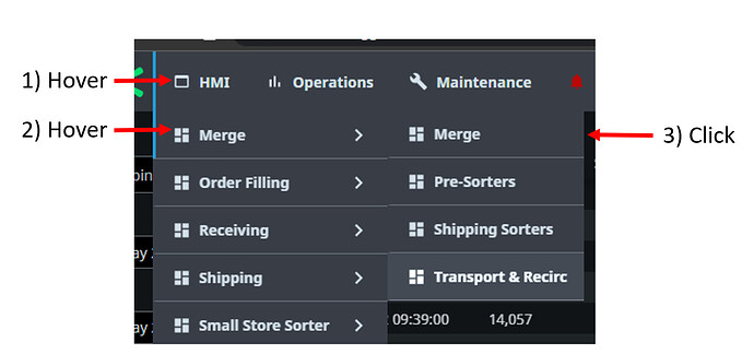

@paul-griffith I want to confirm if there is a way to do the following (so far I think the answer is no):
Navigate the horizontal menu by hover over only with a click being required only on the final item you want to get into:
 ![image](https://us1.discourse-cdn.com/inductiveautomation/original/3X/3/a/3a44f0430a6aacfd5e49249532fbc0915b79f558.jpeg)
Thanks,
Nick
**Post date:** [May 26, 2022, 3:06pm UTC](https://forum.inductiveautomation.com/t/open-horizontal-menu-items-without-mouse-click/47356/14 "2022-05-26T15:06:53Z")
I don’t know for sure (I’m not involved in the front-end of Perspective, pretty much at all) but my understanding of what’s involved would suggest that you are correct. I think we’d have to implement handling for that at the JS level, and expose it as a prop. Sounds like a feature request/ideas post to me.
