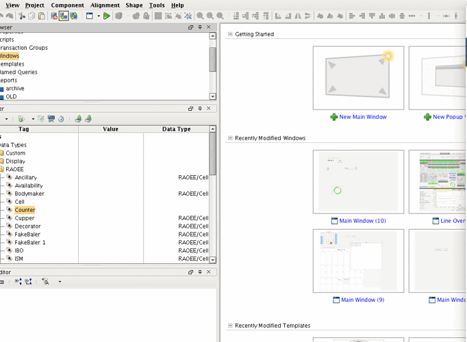

![](https://us1.discourse-cdn.com/inductiveautomation/original/2X/7/7723907cbc0af3324d5f836a678105e2726206de.png)
I have the config from the photo…and i want to show that popup when my temp reaches 30 degrees…it should work…but it doesn t. in the photo the server isn t connected, but it doesn t work even when i connect it.i can t even open a warning window…any help?

Tag Event scripts are run on the gateway, the gateway cannot open windows on the client. You need to write a script in Project - Client Event Scripts - Tag Change.
