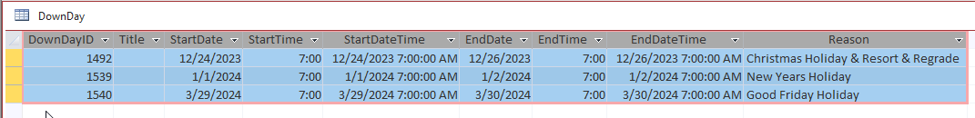

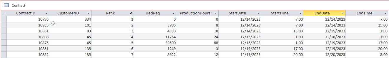

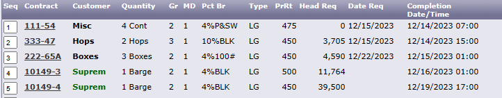

I have two MySQL tables. One table has an "order" with a start date, another table has scheduled downtime. I know how many hours will be needed to fulfill the order but also need to account for downtime to calculate a delivery date. What's the best way to go about this?
Order Table
 ![image](https://us1.discourse-cdn.com/inductiveautomation/original/3X/7/f/7fb8432ac08f6d886de3ed02c24273564683fefd.png)
Downtime Table

Resulting Schedule
 ![image](https://us1.discourse-cdn.com/inductiveautomation/original/3X/a/5/a5f5872f6073c4f9002b042981ec435b85d14c08.png)
**Author:** ![bkarabinchak.psi](https://sea1.discourse-cdn.com/inductiveautomation/user_avatar/forum.inductiveautomation.com/bkarabinchak.psi/32/83567_2.png) [@bkarabinchak.psi](https://forum.inductiveautomation.com/u/bkarabinchak.psi)\
**Post date:** [December 14, 2023, 6:23pm UTC](https://forum.inductiveautomation.com/t/padding-dates-of-one-table-based-off-a-different-table/83157/2 "2023-12-14T18:23:08Z")
The formula is
`Delivery date = start date + down time + expected + production hours`?
If this is not it please specify what it is.
If you can create or calculate a StartDateTime in your Contracts table (like you have in your DownDay table) You can start like
```auto
SELECT
ContractId,
StartDateTime as startTime,
ADDDATE(StartDateTime, INTERVAL ProductionHours HOUR) as initialDeliveryTime
FROM Contract
This will tell you the delivery date sans any downtime. You could then check if the start/end dates of any dowtime are between the startTime/initialDeliveryTime and if so add to it appropriately.
This is a bit complex and you may want to include scripting in calculating this as opposed to strictly SQL. I don't doubt it can be down strictly in SQL but it may get hairy fast.
**Post date:** [December 14, 2023, 8:17pm UTC](https://forum.inductiveautomation.com/t/padding-dates-of-one-table-based-off-a-different-table/83157/3 "2023-12-14T20:17:01Z")
The order table looks generated according to the ProductionHours column. If you were looking for a scripted solution:

That said, since we don't know how the orders table is populated, it makes it a bit more difficult.
**Author:** ![Micky.Franks](https://avatars.discourse-cdn.com/v4/letter/m/c57346/32.png) [@Micky.Franks](https://forum.inductiveautomation.com/u/Micky.Franks)\
**Post date:** [December 14, 2023, 8:33pm UTC](https://forum.inductiveautomation.com/t/padding-dates-of-one-table-based-off-a-different-table/83157/4 "2023-12-14T20:33:20Z")
The orders table is populated via a form and insert query.
