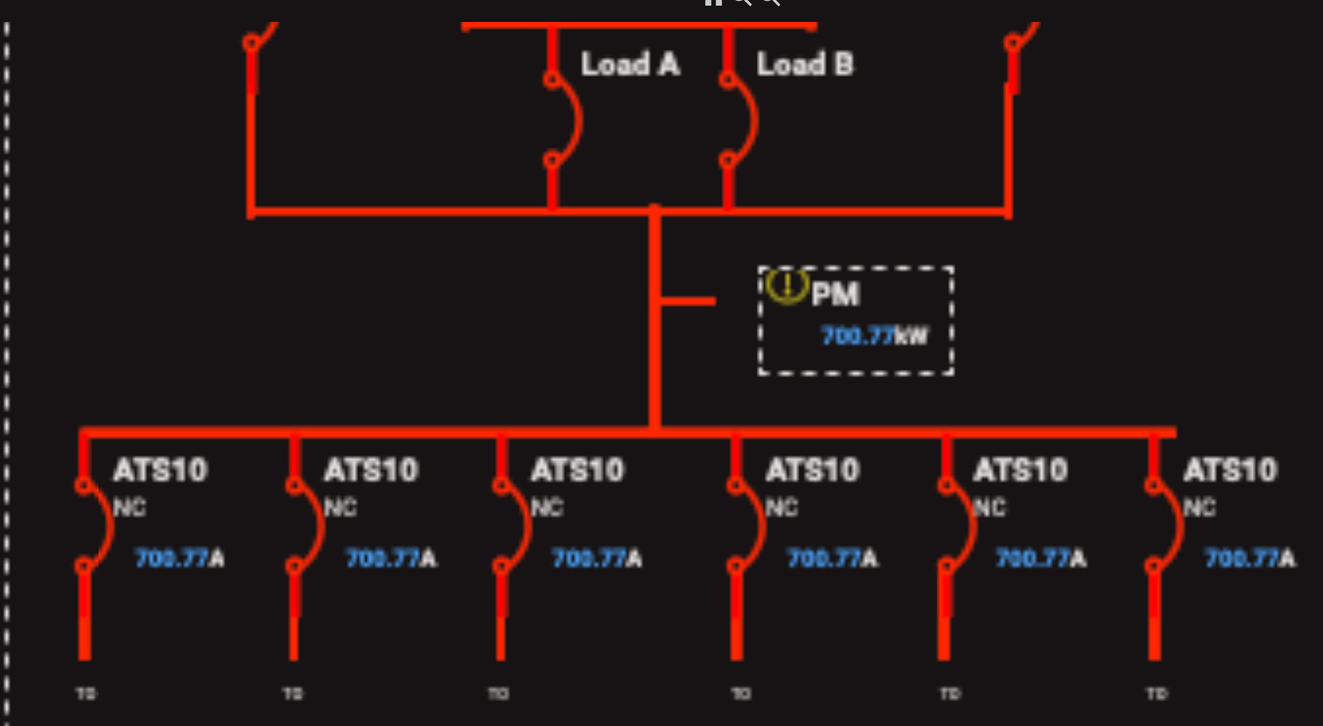

I noticed something interesting while using this with the safari browser. Through my brief research it appears Safari renders differently than a browser like Chrome (blink) and under medium-high zoom conditions, the Safari renderings of Labels, svgs, etc look extremely blurry, whereas Chrome stays sharp. I’ve provided screenshots for reference. I was wondering if this is something I, as a user can fix (CSS?) or is this something else entirely?
 ![image](https://us1.discourse-cdn.com/inductiveautomation/original/3X/7/4/7474d13c474113f7130c27fb668e8ff28b7055a6.jpeg)
 ![image](https://us1.discourse-cdn.com/inductiveautomation/original/3X/7/7/77c2b4e52368b9a803491f00d46ef297ad3c7233.png)

Justin
We are looking into this but it does seem to be a known Safari challenge.
We are looking to change the module to using Tramsform:Matrix() which should improve things but unsure of a roll out date for this.
