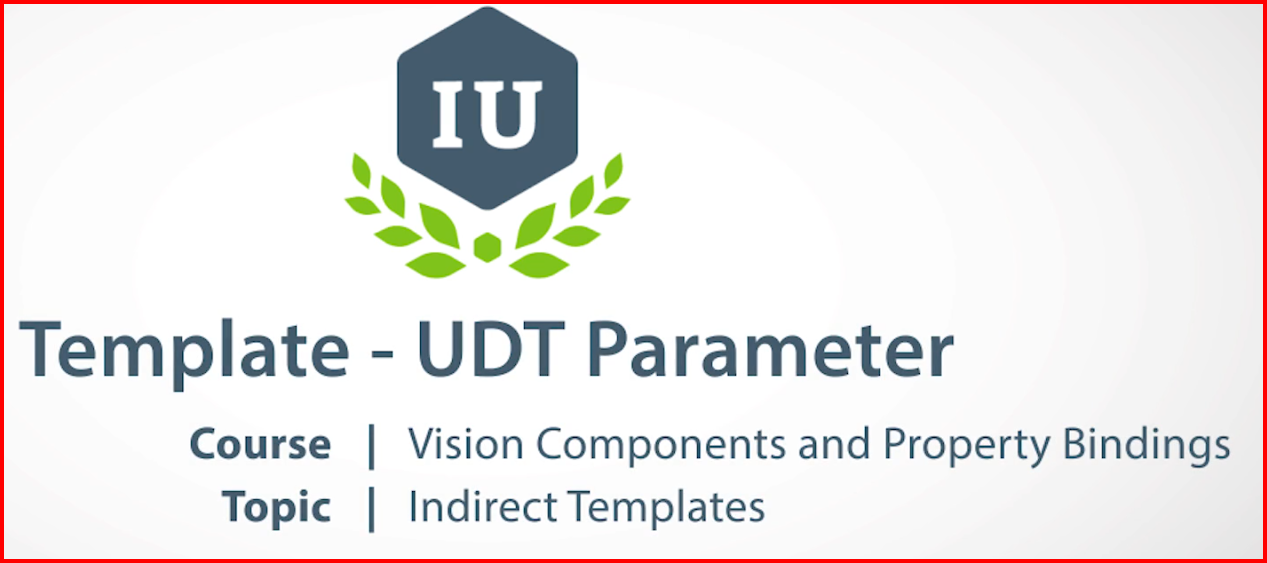

Hi Robertm:
Was this the video you were referring to?
 ![UDT](https://us1.discourse-cdn.com/inductiveautomation/original/3X/c/7/c74c9d68e55a1668920278eebf82ad4cbad7d83e.png)
**Post date:** [July 25, 2025, 5:27pm UTC](https://forum.inductiveautomation.com/t/parameter-files/108767/10 "2025-07-25T17:27:21Z")
Thats the one NOT to use. Dont pass the UDT, but pass a string that identifies the tag path to the root of the UDT.
