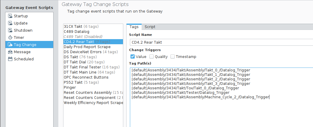

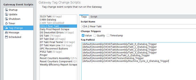

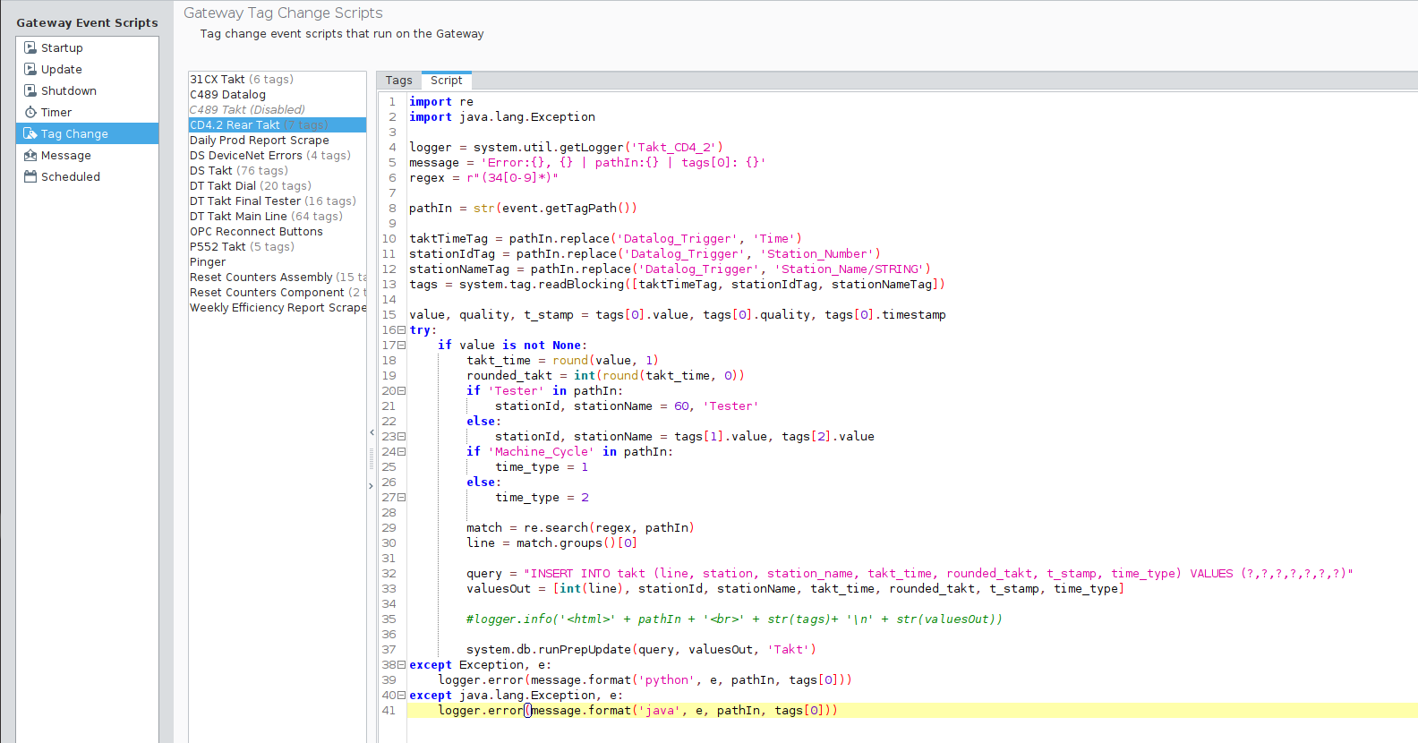

An example (Apologies, I don't normally post just screenshots of code, but this is for illustrative purposes):
 ![image](https://us1.discourse-cdn.com/inductiveautomation/original/3X/1/6/16ca6ae456301da1bca7e25359e2e7f0a8360a70.png)
 ![image](https://us1.discourse-cdn.com/inductiveautomation/original/3X/3/d/3d8d2889f6c6f2c76e49a58055aa4cb4e30021a2.png)
