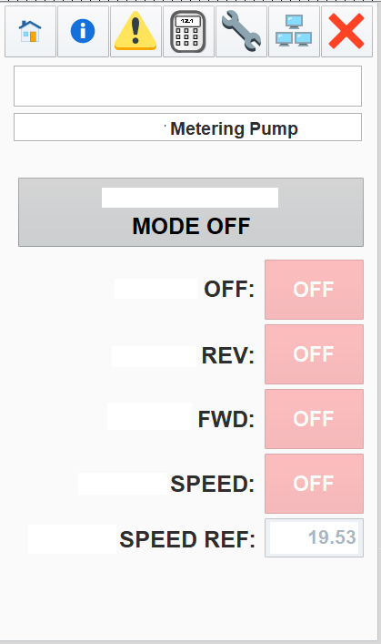

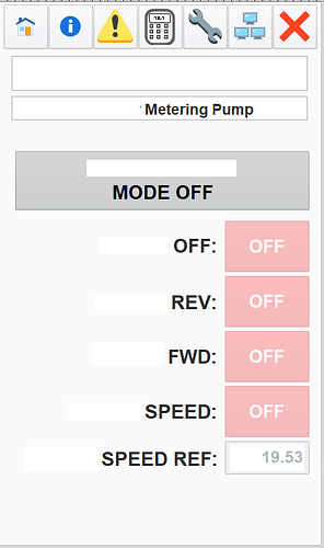

We actually have the button strip as a template that gets loaded along with the other templates.
It then references the window to get to the other template(s) and set visible, not visible on the "tabs"(containers)
Keeps it simple and you can also do access level controls on the buttons easier too.
 ![DevicePopup](https://us1.discourse-cdn.com/inductiveautomation/original/3X/2/b/2bda52f199ed7f32c5991fffd8eb664ec54f9c8d.png)
