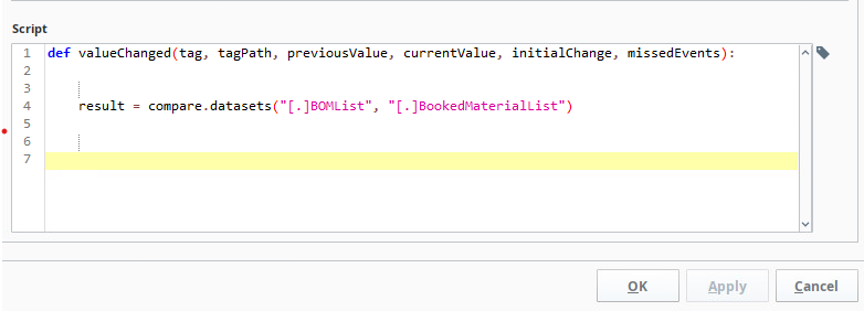

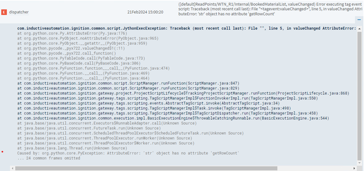

I have two tags with datatype Dataset and a function to compare the value of a column exists in both of them. but i can't pass the two tags to the functions as a dataset they are passed as string.
what should i do?
 ![Function](https://us1.discourse-cdn.com/inductiveautomation/original/3X/c/d/cdade7d859565c53311960858742f95981701ff1.png)
 ![TagChangeScript](https://us1.discourse-cdn.com/inductiveautomation/original/3X/e/d/ed587cd6f38aad9dc47a04f34efaeb1accd096f5.png)
 ![error](https://us1.discourse-cdn.com/inductiveautomation/original/3X/2/9/29708376bad4825a7069d683efe0ab352982f95c.png)
**Post date:** [February 21, 2024, 3:43pm UTC](https://forum.inductiveautomation.com/t/passing-dataset-tags-to-a-defined-function-in-the-project-library/86107/2 "2024-02-21T15:43:35Z")
You need to call system.tag.readBlocking to actually... Read the tag values 🙂
Otherwise, you're just dealing with a literal string.

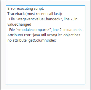

**Author:** ![Abdelrahman\_Bahgat](https://avatars.discourse-cdn.com/v4/letter/a/ba9def/32.png) [@Abdelrahman\_Bahgat](https://forum.inductiveautomation.com/u/Abdelrahman_Bahgat)\
**Post date:** [February 21, 2024, 4:13pm UTC](https://forum.inductiveautomation.com/t/passing-dataset-tags-to-a-defined-function-in-the-project-library/86107/3 "2024-02-21T16:13:51Z")
thank you.
I did it but this error appears. I can't use dataset functions in the project script library right?
 ![err](https://us1.discourse-cdn.com/inductiveautomation/original/3X/2/4/24ee293de8ac3420edd6e8a6e66bc4aed3ae5b03.png)
**Post date:** [February 21, 2024, 4:22pm UTC](https://forum.inductiveautomation.com/t/passing-dataset-tags-to-a-defined-function-in-the-project-library/86107/4 "2024-02-21T16:22:31Z")
Something is not the type your program is expecting.
This error does not line up with any of the code that you have previously shown. Show the code as it is now, in a preformatted text block. Also, would be nice to know how these two tags are configured, and what the data in their value looks like.
**Post date:** [February 21, 2024, 4:46pm UTC](https://forum.inductiveautomation.com/t/passing-dataset-tags-to-a-defined-function-in-the-project-library/86107/5 "2024-02-21T16:46:07Z")
> [@Abdelrahman\_Bahgat](#):
Wrong. Your error indicates you tried to use a dataset method on an object that is an ArrayList, not a dataset.

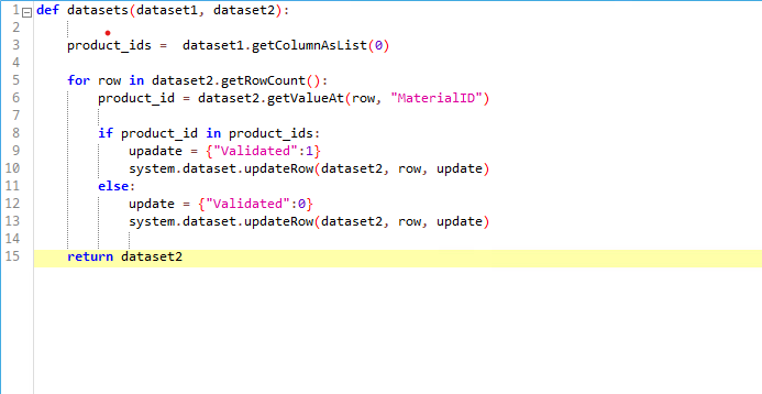

the two tags I'm using are:
BOMList : Query tag (Dataset [20R_5C]) data is queried from the database
BookedMaterialList : Memory tag (Dataset [23R_6C]) operator is entering the data manually.
```auto
def datasets(dataset1, dataset2):
    colindex= dataset1.getColumnIndex("MaterialID")
    product_ids = dataset1.getColumnAsList(colindex)
    for row in dataset2.getRowCount():
      	product_id = BOM.getValueAt(row, "MaterialID")
       	if product_id in product_ids:
       		upadate = {"Validated":1}
       		system.dataset.updateRow(dataset2, row, update)
       	else:
      		update = {"Validated":0}
    return dataset2

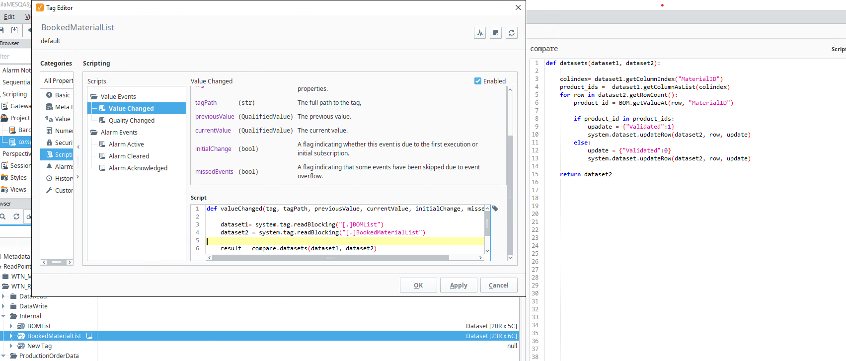

**Post date:** [February 21, 2024, 5:08pm UTC](https://forum.inductiveautomation.com/t/passing-dataset-tags-to-a-defined-function-in-the-project-library/86107/7 "2024-02-21T17:08:10Z")
You're sending a List of qualified values, not the dataset. Thus the error. To properly get the value you need something like:
```auto
value = system.tag.readBlocking(listOfTagPaths)[indexOfPath].value
Your value change event should be:
```auto
datasets = [qv.value for qv in system.tag.readBlocking(['[.]BOMList','[.]BookedMaterialList'])]
compare.datasets(datasets[0],datasets[1])
Although, I will say this isn't the best way to approach this. As Phil would say "The dragons are circling".
**Post date:** [February 21, 2024, 5:12pm UTC](https://forum.inductiveautomation.com/t/passing-dataset-tags-to-a-defined-function-in-the-project-library/86107/8 "2024-02-21T17:12:38Z")
> _Memory tag (Dataset [23R_6C]) operator
Tags are global - what happens if two operators are attempting to update the booked material list at the same time?
I wouldn't expect a library method named `compare.datasets` to require a specific input shape of dataset, either; should probably have a more useful name.
> [@lrose](#):
Nit: I like unpacking for situations like this:
```python
bomList, bookedList = [qv.value for qv in system.tag.readBlocking(['[.]BOMList','[.]BookedMaterialList'])]
compare.datasets(bomList, bookedList)
