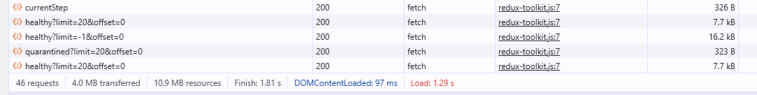

Installed a couple of Sepasoft modules and then updated them. The original module versions that are running are shown, but not the installed updates.
 ![image](https://us1.discourse-cdn.com/inductiveautomation/original/3X/9/a/9a8de2bf66ad8988b5f03367adae948ea10d782a.png)
Production and OEE are the updated modules. Is there anything Sepasoft should do to our modules to make them show as "pending restart"?

> [@Jeff\_Fitch](#):
Module upgrades should show up automatically as required updates pending restart; that's all handled in the module manager.
What's the build date of the gateway you're working off? It looks like the banner wasn't actually wired up to anything on the backend until 12/16, so is it possible your gateway is just older than those changes?

Hey Jeff,
I suspect that our Modules page is just not representing the case where a module is installed and another copy/version of the same module is pending install. I'll do some testing and see if we can improve that.
One thing that's odd though: In your screenshot, I see Production up at the top there showing as active/in trial, but I don't see OEE. Is OEE just missing from the screenshot, or was it not showing up on the Modules page at all? If both Production and OEE were already installed and then updated the same way, I'd expect them to show up similarly in the Modules Data Grid.
Would you be able to share the backend responses next time you run into this? Seeing those responses would show us exactly what's happening and help us to determine next steps. Some instructions below on how to find them:
1. In your browser's Developer Tools (F12 or ⌘+⌥+I on Mac), under the Network tab, you'll see a list of network requests.
2. When you first load or refresh the Modules page, there should be two requests down at the bottom of that list starting with "quarantined" and "healthy."
3. If you click on each of those and then the Response tab, it'll show you the raw data that the Modules page is using to render the list of modules, which you can copy and paste here.

**Author:** ![Jeff\_Fitch](https://sea1.discourse-cdn.com/inductiveautomation/user_avatar/forum.inductiveautomation.com/jeff_fitch/32/71281_2.png) [@Jeff\_Fitch](https://forum.inductiveautomation.com/u/Jeff_Fitch)\
**Post date:** [January 10, 2025, 7:34pm UTC](https://forum.inductiveautomation.com/t/pending-install-modules-dont-show-if-they-are-an-update-of-an-existing-module/100627/6 "2025-01-10T19:34:05Z")
Hi Andrew,
Did an upgrade of all my modules but didn't restart. I'll wait to hear from you before I restart. This gateway can sit until Monday. Here's the data from the dev tools and a screen shot.

Andrew,
I hit refresh on the browser and noticed there are 3 "healthy" data sets.
 ![image](https://us1.discourse-cdn.com/inductiveautomation/original/3X/4/1/41fbb23d3ed0081c6e55e7db553e8a205c9a0342.png)
Jeff
**Author:** ![Andrew\_Kassis](https://sea1.discourse-cdn.com/inductiveautomation/user_avatar/forum.inductiveautomation.com/andrew_kassis/32/74187_2.png) [@Andrew\_Kassis](https://forum.inductiveautomation.com/u/Andrew_Kassis)\
**Post date:** [January 10, 2025, 11:27pm UTC](https://forum.inductiveautomation.com/t/pending-install-modules-dont-show-if-they-are-an-update-of-an-existing-module/100627/8 "2025-01-10T23:27:23Z")
Hey Jeff,
Thanks for grabbing and sharing those! I only see one Sepasoft module in that response, but that's my fault for asking for the initial response rather than a later response with updated sorting or a higher view limit. No worries though, feel free to restart your gateway.
I still need to do some testing on my end, but I have a pretty good idea of what to look for here and what we'll likely want to fix. I don't believe it's anything to do with your modules, so nothing to do on Sepasoft's end. Thanks again for letting us know about this.
**Post date:** [January 10, 2025, 11:28pm UTC](https://forum.inductiveautomation.com/t/pending-install-modules-dont-show-if-they-are-an-update-of-an-existing-module/100627/9 "2025-01-10T23:28:55Z")
That's expected, the datagrid will continually poll that endpoint to look for changes. If you're still on that page, one of the newer responses would be helpful (ideally with your updated modules shown up at the top or more than 20 items showing), but no worries if not!
**Post date:** [January 10, 2025, 11:36pm UTC](https://forum.inductiveautomation.com/t/pending-install-modules-dont-show-if-they-are-an-update-of-an-existing-module/100627/10 "2025-01-10T23:36:04Z")
This is the the one with the -1 as the limit.

This is the other limit=20
**Post date:** [January 10, 2025, 11:48pm UTC](https://forum.inductiveautomation.com/t/pending-install-modules-dont-show-if-they-are-an-update-of-an-existing-module/100627/12 "2025-01-10T23:48:32Z")
That's perfect, thanks! I'm going to make a ticket for this and sync up with a backend dev early next week.
