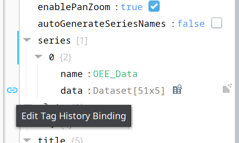

I have time series chart with a series that is bound to a tag history dataset. Currently it updates on pull down event script 'onActionPerformed'. It is working fine, but I would like the chart to update every 5 seconds in the browser session.
How can I acheive this?
I considered creating a memory tag that flips state every 5 seconds and the run an event script from that, but it doesn't seem efficient and I couldn't work out how to do that anyway 🙂
I feel like there must be an easy way built into Perspective to acheive this functionality.
![image](https://us1.discourse-cdn.com/inductiveautomation/original/3X/e/1/e1f3fa412f1021127ff2095ac9714e9ee6bf9962.png)
 ![image](https://us1.discourse-cdn.com/inductiveautomation/original/3X/b/2/b2c7ff44aac7dec2eafeedd8ca87ce4434099f99.png)
Thanks
**Post date:** [April 8, 2024, 12:00pm UTC](https://forum.inductiveautomation.com/t/periodical-refresh-of-a-tag-history-dataset/88490/2 "2024-04-08T12:00:46Z")
Arrange for your start/end timestamps to be tied to datatime properties that advance every five seconds. Typically by including `now(5000)` in their expressions.
