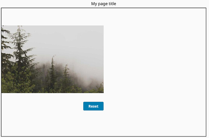

Thanks for pointing out that, I used that View canvas and works fine, can add some points on click in my "drawing area".
So, on the canvas view itself, I added that onClick event to add one more instance item of type "Point" (another view I create that is only a single point).
Problem is... I get pageX and pageY, that shift my all marking based on view origin. Tried some different setup with absolute / relative positions, but that does not change much.
Any idea where could retrieve views / view canvas origin position? I could not locate that in view properties.

 ![Screenshot 2025-08-05 at 22.40.19](https://us1.discourse-cdn.com/inductiveautomation/original/3X/2/a/2a8753923b480025979231f4eb10bfb1de0b360b.jpeg)
**Post date:** [August 5, 2025, 10:56pm UTC](https://forum.inductiveautomation.com/t/perpective-label-annotation/109351/4 "2025-08-05T22:56:39Z")
I was experimenting with this before. See [View Canvas mouse click coordinates](https://forum.inductiveautomation.com/t/view-canvas-mouse-click-coordinates/84636). We didn't get an answer.
Watch out, if you do get it working somehow, that it still works at different browser zoom levels.
