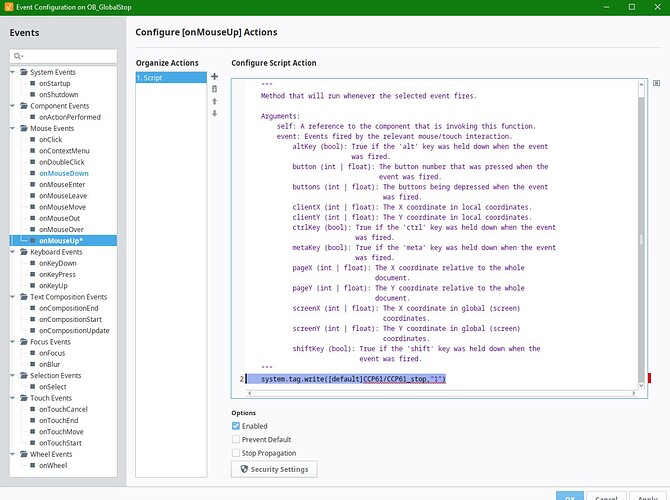

I’m trying to do it by toggling 4 different bits with “onMouseDown” & “onMouseUp” event scripts.
**These are the Tag Paths** (Copied & Pasted from each individual tag)
- [default]CCP61/CCP61\_stop
- [default]CCP62/CCP62\_stop
- [default]CCP63/CCP63\_stop
- [default]CCP71/CCP71\_stop
I have tried this: ⬇, Adding a separate script for each tag but I keep getting the red squiggly underline and a "no viable alternative at input ‘CCP61’ " message when I hover the cursor over the text.
 ![Screenshot 2022-01-20 113946](https://us1.discourse-cdn.com/inductiveautomation/original/3X/9/1/919c81e9082093b36887607f036774b68fc457b8.jpeg)

Your tag adress is a string, so you need to write that line like this:
```auto
system.tag.write('[default]CCP71/CCP71_stop',1)
You can also write all of them at the same time using **system.tag.writeAsync()**
```auto
tagList = ['[default]CCP71/CCP71_stop',
			'[default]CCP63/CCP63_stop',
			'[default]CCP61/CCP61_stop']
valuesList = [True,True,True,True]
system.tag.writeAsync(tagList,valuesList)
So you can just provide a list of tag paths and values and do it all at once, efficiently.
You can take a better look at how it works here:
[https://docs.inductiveautomation.com/display/DOC81/system.tag.writeAsync](https://docs.inductiveautomation.com/display/DOC81/system.tag.writeAsync)

I’ve eddited on my response, but since you’re toggling bits, you can’t write `"1"` to them, since you’re indicating that that 1 is actually a string, the correct way would be to just use **1** or **True**

So for now I used a separate script for each tag using **system.tag.write()**. I couldn’t get **system.tag.writeAsync()** to work. Thank You
