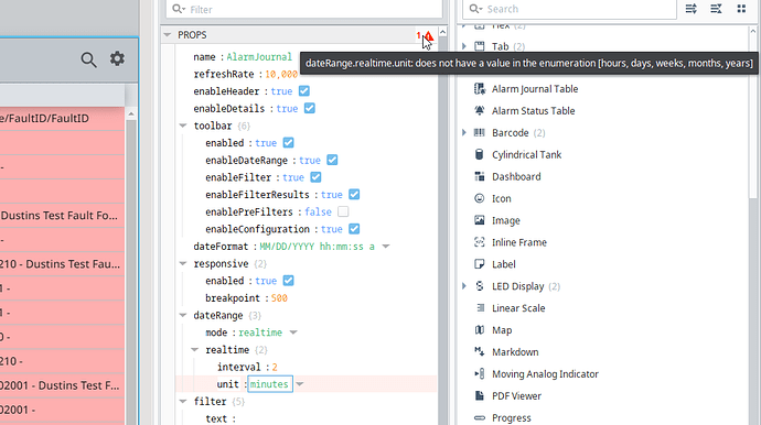

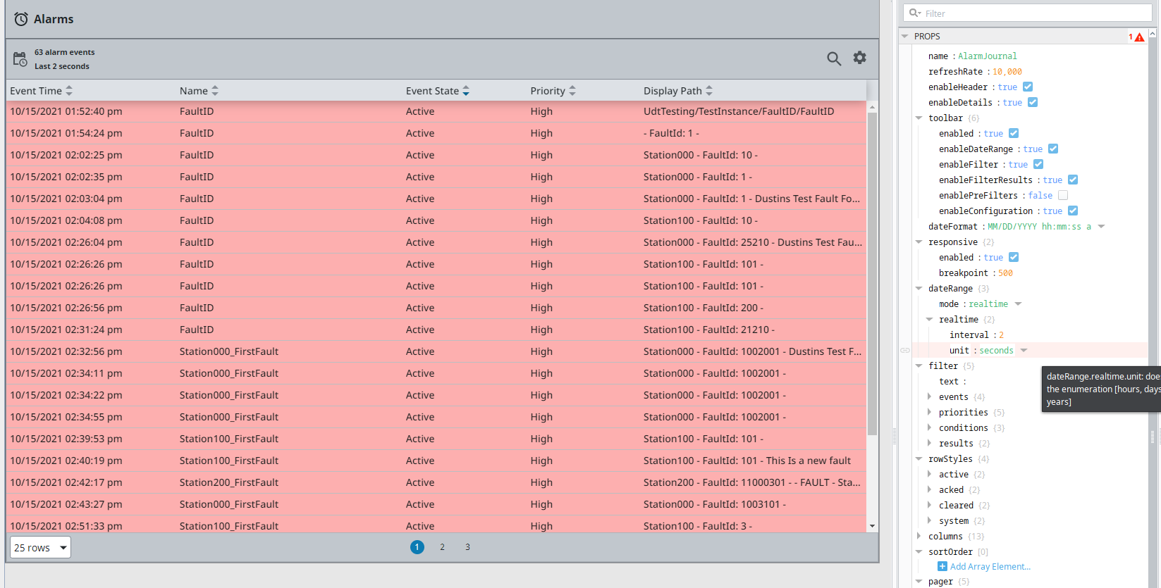

I noticed that the daterange selector in the perspective alarm journal control has seconds and minutes as listed options, but the enum in the designer starts at hours and when seconds or minutes are selected an error is show at design time. Is there a way to remove these options from the daterange selector in the alarm journal or to add them to the enumeration for the date range selector?

I’m going to bump this - This is also the case for me. Using Ignition 8.1.7.
Selecting seconds / minutes results in a broken time range query - it’s an ugly one.
