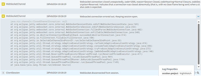

About two weeks ago, my apps that have been accessible externally (for several years) started failing to load.
They just stop at "Connecting..."

The External\_IP:8088 gets passed from outer firewall to inner Business firewall, which allows access to Ignition server. This has worked ever since I set it up several years ago. On the off-chance something got changed, I decided to re-path it via inner Process firewall and get to the Ignition server via its other ethernet card. This did not correct my issue. The apps still get stuck at connecting.
I get these Websocket messages in the event log, which points me more toward a firewall issue, but as far as I can tell, nothing got changed on the firewall in the past month:
 ![image](https://us1.discourse-cdn.com/inductiveautomation/original/3X/b/8/b898e8e0687661b4379c58fa8841aa60f56da3ce.png)
I tried turning off Auto Detect and setting my public IP and port, but that did not help - it just caused my internal IP connections to fail in the same way, as it was redirecting them to External IP.

**Author:** ![gloweware](https://avatars.discourse-cdn.com/v4/letter/g/e0b2c6/32.png) [@gloweware](https://forum.inductiveautomation.com/u/gloweware)\
**Post date:** [May 14, 2024, 8:09pm UTC](https://forum.inductiveautomation.com/t/perspective-apps-failing-at-connecting-using-external-ip/86603/2 "2024-05-14T20:09:07Z")
I did 'half' figure this out.
I ended up removing are re-creating all the firewall rules and most of my issues went away.
There are still one or two pages that do not load consistently...on a sunny day, they will connect properly.
This does appear to be a firewall issue, just not sure how to proceed further without flashing it back to factory and starting anew.

**Post date:** [November 11, 2024, 2:55pm UTC](https://forum.inductiveautomation.com/t/perspective-apps-failing-at-connecting-using-external-ip/86603/4 "2024-11-11T14:55:02Z")
> [@Marco\_Keller](#):
> source of the error?
Websocket errors are, from what I've seen here, **always** a firewall/router issue. Some old network hardware just doesn't work properly with websockets. Especially old security appliances that do deep packet inspection.

**Post date:** [November 11, 2024, 3:50pm UTC](https://forum.inductiveautomation.com/t/perspective-apps-failing-at-connecting-using-external-ip/86603/6 "2024-11-11T15:50:55Z")
> Is every Perspective Session a Websocket?
Yes, mandatory.
Advise your client to use a modern, competent, proxy technology. (That is, not MS, IMNSHO.)
