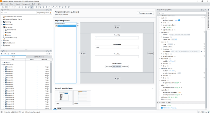

Hi, I’m trying to make an inventory tracking system and need multiple barcodes to scan them in and out of the closet. I already have the scan barcode button as well as 2 barcodes created. My problem is that no matter what barcode I scan, it writes the output to my first tag in my script. I need every barcode to write an output to a different tag. Can someone help me out?

The ‘barcode scanned’ event is generic - _every_ barcode you scan will call in to the same event. You need to configure your ‘Scan Barcode’ action with additional “context”, which you then retrieve in the barcode event script and use to determine which tag to write to.

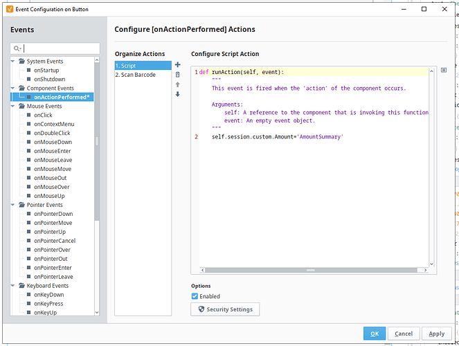

![Capture5](https://us1.discourse-cdn.com/inductiveautomation/original/3X/d/b/dbab7d776a787cfcf49c50bf804b33fb3d138544.png)
 ![Capture6](https://us1.discourse-cdn.com/inductiveautomation/original/3X/8/e/8ebe60a445cf59a77dcbe4a66cbbc0ff34c61562.png)
So I create context on my scan event then is this how I retrieve it in the barcode event script?

Okay. I’m going to assume the data that the barcode contains is something to identify which part you’re looking at.
So the first thing you’ll need, somewhere, is a mapping from _part numbers_ to _tag paths_. At least from your screenshots, you have a bunch of numbered `Quantity` tags and nothing else.
So what you probably want to do is something like this:
- Invoke your scan barcode action as you are. Don’t worry about ‘context’ or anything like that.
- In the “Barcode Scanned” event hook, you’ll open a view that will hold the actual data entry. Pass this view a _parameter_ - the actual part number that was scanned.
- In the view, you’ll probably have at least three components:
  - a Label with the part number that’s coming in as a parameter
  - an input field for entering the part count
  - a submit button
- The submit button will have a script that uses the part number and the mapping from above (a DB table or project library script or something similar) to determine which tag to write to, reads the value _from the input_, and writes back to that tag.

If you have different sources of the barcode action, _that_ is where you could use the “context” field to differentiate. So you’d have a “login” context, and a “cycle count” context (or whatever other names you prefer). Then in the single barcode event handling script, you just immediately branch your logic, something like:
 ![image](https://us1.discourse-cdn.com/inductiveautomation/original/3X/6/9/696198f11b45053c4e9d29e5364cc675ee74d498.png)
```python
if context["context"] == "login":
    # do your login related barcode handling
elif context["context"] == "cycleCount":
    # do your cycle count barcode handling
