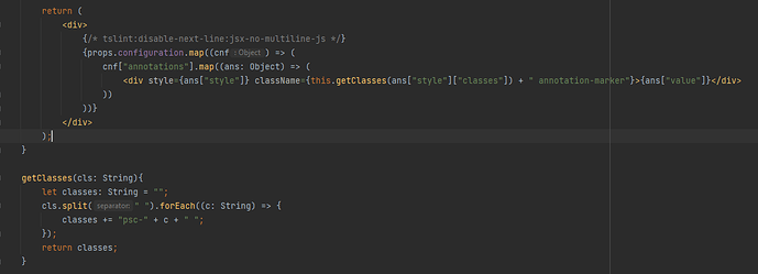

I didn’t think the style tag would be enough, I probably still lack knowledge in react.
It seems that I have to add “psc-” in front of all the classes defined in the project styles in order for them to be taken into account.
 ![image](https://us1.discourse-cdn.com/inductiveautomation/original/3X/d/9/d90a38c883e02b56641a8cef4e212ff4cb5dd04c.png)

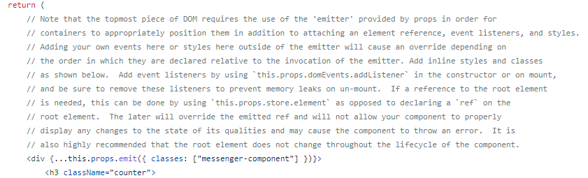

Yes if you dont use the emit you will have to parse it yourself.
Its not necessarily related to react, but more to how igntion passes along the properties^^
You will have to use the emit() somewhere though (best in the top level div), else your component will not be positioned correctly in the view.
this is what it says in the example
 ![image](https://us1.discourse-cdn.com/inductiveautomation/original/3X/7/d/7d50aae356b465825b0a61c4402a2e17af3daefc.png)

I feel like I need to parse the class list in any case.
{…this.props.emit({classes: ans[“style”][“classes”]})} // Doesn’t work
“classes” expects an array while the classes coming from the props of the component ans[“style”][“classes”] are a String.

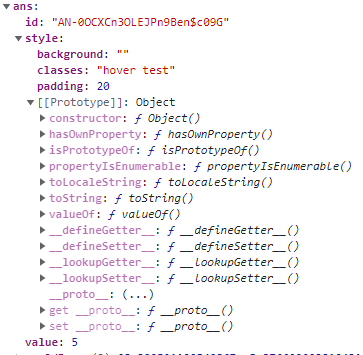

I just tested {...ans.emit()} and {...ans.style.emit()} but it does not work.
It raises the following error: TypeError: ans.style.emit is not a function / TypeError: ans.emit is not a function
![image](https://us1.discourse-cdn.com/inductiveautomation/original/3X/f/2/f209806aa43d3ce8f14361d9852d03d508326378.png)
