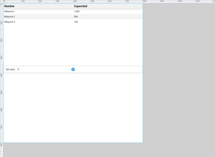

I’m traying to display a table based on a Named Query, and change it background color based on a cell value, but I can’t find anything to do that.
This is my table
 ![image](https://us1.discourse-cdn.com/inductiveautomation/original/2X/7/7b8a7551f077fd88f8fbc6bf6d18322646baec8c.png)
How can I change a row background color based on his “Capacidad” value?

You have to build a transform on the data binding to add a style value to each row. Might not be the most elegant code to get it to work, but works for us.
```auto
	import json
	recipe = value
	data = []
	list=[]
	for row in range(len(recipe)):
		ds = recipe[row]
		a= ds.a
		b= ds.b
		c= ds.c
		if c:
			style = '#87C7E6'
		else:
			if row%2 == 1:
				style = '#FFFFFF'
			else:
				style = '#E5E5E5'
		row={"style":{"backgroundColor":style},"value":{"a":a,"b":b,"c":c}}
		list.append(row)
	return list
