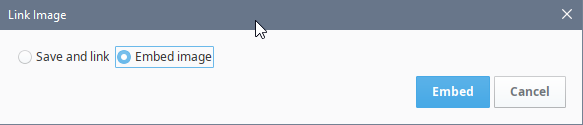

Hello, I would like to utilize some of the icons that are available in [Material.io](http://Material.io) yet not all display for me. I’ve tried using both the icon (material/image name) and image component (uploading the svg files to Image Management).
Thank you,
Eileen

We’re working on integrating the creation of the Material icon sprite into our build process so it will be evergreen. Right now, we create the sprite as needed, but we’re sometimes behind what is currently offered on the [Materil.io](http://Materil.io) site between releases.
If the icon you want isn’t available to use with the Icon component, you can download it as an SVG and just drag it into the designer. When you drop it onscreen, you’ll have the option to “Save and link” or “Embed image”. Choose the later:
![image](https://us1.discourse-cdn.com/inductiveautomation/original/3X/5/7/57da87d665f53361256ff1b260480d59450d56ae.png)
That will create an SVG element and properties for you that you’ll be able to adjust as needed:
 ![image](https://us1.discourse-cdn.com/inductiveautomation/original/3X/8/7/87a9111626fb86775838892d936bc58b7412e2fc.png)
