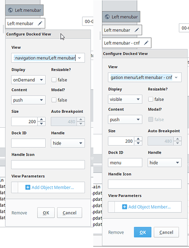

Not what he meant. As in you should have _two_ extra docks defined for the page, 3 in total including the shared one. The first extra should be _exactly_ the same viewpath as the shared dock uses (not just the same view name ) . This will override the shared dock config. This should be overridden to onDemand so it's hidden. And then the second extra dock wh should be your actual dock you want shown

**Post date:** [August 2, 2025, 5:36pm UTC](https://forum.inductiveautomation.com/t/perspective-dock-overrides/35411/11 "2025-08-02T17:36:29Z")
All clear now, works fine, thanks for the clarification.
Added down here example of that working fine setup.
On left side, the second docked view over-riding the original one with an onDemand setup.
On right side, my other docked view to be made visible.
