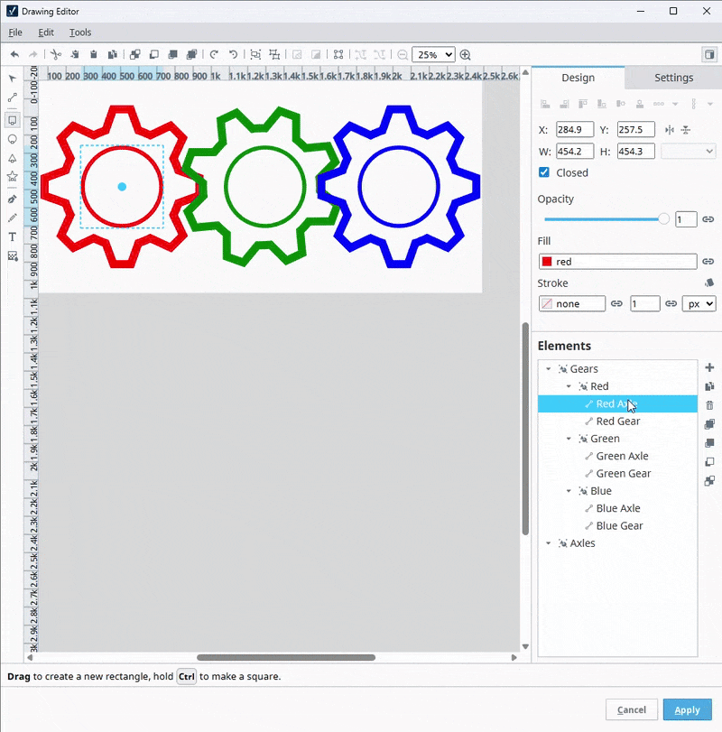

I'm excited to share some major updates to the **drag and drop functionality** of the Drawing Editor’s Elements panel that will make organizing your elements more intuitive.
The biggest change is the ability to **move multiple elements at once!** No more dragging one element at a time—select as many as you need and move them all together even if the selected elements are from different parent groups.
Other improvements:
- When moving multiple items, if you've selected a group and some of its descendants, the editor is smart enough to just move the group element.
- Dragging an element now shows a visual indicator to help you know exactly where it will land:
- The drag 'ghost' now has an offset that clearly indicates the nesting level your elements will move to, which is especially helpful when working with deeply nested groups.
- If you attempt an "invalid" drag (like trying to drag a parent group into one of its own children), you won't see a placement indicator, letting you know that the action won't be applied.
- When moving multiple elements, the drag ghost now displays the _number_ of elements being moved instead of the just one element's name.
A welcome side effect of internal improvements to support this drag and drop functionality is that the Duplicate Element functionality now reliably places the duplicated elements into the expected element positions- whereas before it could get “confused” as individually duplicated elements shifted.
Let us know what you think in the comments below and I hope to have some more Drawing Editor improvements for you all in the very near future 🙂
