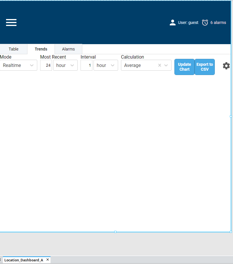

**Post date:** [October 22, 2019, 2:28pm UTC](https://forum.inductiveautomation.com/t/perspective-error-creating-view/24856/26 "2019-10-22T14:28:21Z")
I have the same issues still in 8.0.5, tried all the jre runtime options to no avail.
As of now, it appears I can only have one instance of any one view open in the Designer successfully. If I try to open a second view, I consistently get ‘view config is undefined’.
 ![image](https://us1.discourse-cdn.com/inductiveautomation/original/2X/2/23cd31b30decf5a9726eb83e9acc0975c2cc8dc0.png)
First view after opening designer opens successfully:
 ![image](https://us1.discourse-cdn.com/inductiveautomation/original/2X/8/810a4d4c4aa300b6454dced8fee017236e84eec3.png)
Any subsequent view sticks on ‘synchronizing’ and fails:
 ![image](https://us1.discourse-cdn.com/inductiveautomation/original/2X/c/c8c9dca35d201542a7aa8c90fe4a32fdcba07217.png)
To be able to open any single view now, I have to restart the designer and open that view FIRST before any others are opened in the designer session. After changes are made and published, I then have to restart the designer before I can open any other view.
This is after upgrading from 8.0.3 to 8.0.5. I still had issues in 8.0.3 but I don’t remember them being quite this bad. I have tried the above JRE arguments and different memory configs without any success. Anyone else have any advice?
