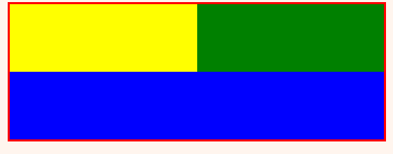

Here's a flex-row container (red border) containing 3 flex-column containers:
 ![image](https://us1.discourse-cdn.com/inductiveautomation/original/3X/5/b/5b3861572d348650c318a7c48345bde251426697.png)
Is this what you have ?
the flex-row is set up with grow: 0 and shrink: 0,
the 3 flex-column are set up with grow: 1 and shrink: 1 and a 200px basis, which doesn't actually do anything since they can shrink and grow.
It scales like you'd expect:
 ![image](https://us1.discourse-cdn.com/inductiveautomation/original/3X/a/b/ab404ccd9bf2b214ac3791771412dc9a3d99e133.png)
 ![image](https://us1.discourse-cdn.com/inductiveautomation/original/3X/e/a/ea2031c162091d7dcce206553fcb894928d71b44.png)
note:
I'd probably keep shrink: 0 on the inner containers, set a sane basis, then set the outer one to wrap.
So you keep things large enough to display your data, and it doesn't get ugly when the viewport gets small:
![image](https://us1.discourse-cdn.com/inductiveautomation/original/3X/b/e/bed7660e4ac730bbf4237a1e9dffaf8fe43d4672.png)
 ![image](https://us1.discourse-cdn.com/inductiveautomation/original/3X/3/e/3ee74ecfd1883ff7a3bef7e074f60fed82bdd4b4.png)

Well it seems like the containers did shrink. Their content didn't. Set `shrink: 1` on the labels too, or maybe change the font size to something dynamic instead of `px` or `pt`. I can't tell you exactly which one to use, but try something like `rem` or `vw` or some other relative units.
That said, if your application was made for big monitoring screens, you could also design the view differently, in a way that's more suited for mobile devices, using a breakpoint container for example.
