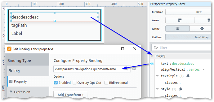

Hi,
I think this is a bug, this is how my instances looks in the flex repeater:
 ![image](https://us1.discourse-cdn.com/inductiveautomation/original/3X/c/0/c052e8f281486120d17dae3627d7c58f1842cbd2.png)
The resulting view picks up the other parameters (“Type/Description”) but not anything under “Navigation”
Here is the targeted view:
 ![image](https://us1.discourse-cdn.com/inductiveautomation/original/3X/c/e/ce89e2f824282b235ede119326727b9f218c2c6a.png)
And here is the live client view:
 ![image](https://us1.discourse-cdn.com/inductiveautomation/original/3X/4/0/403cd69dc4ed1dfedf5797aad80007e7a66c06d6.png)
**Post date:** [December 30, 2021, 2:55pm UTC](https://forum.inductiveautomation.com/t/perspective-flex-repeater-cannot-handle-dictionary-input-within-the-instance-parameters/54542/2 "2021-12-30T14:55:47Z")
You need to bind each item on the template to the particular parameter that’s being passed in.
Sorry, original post was erroneous.
On the template view select each component and bind the text to the view’s params.

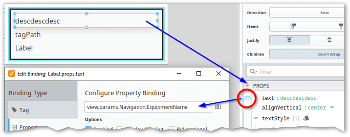

**Author:** ![tordvd](https://sea1.discourse-cdn.com/inductiveautomation/user_avatar/forum.inductiveautomation.com/tordvd/32/11525_2.png) [@tordvd](https://forum.inductiveautomation.com/u/tordvd)\
**Post date:** [December 30, 2021, 4:12pm UTC](https://forum.inductiveautomation.com/t/perspective-flex-repeater-cannot-handle-dictionary-input-within-the-instance-parameters/54542/3 "2021-12-30T16:12:33Z")
Thank you,
but they are bound on the template (card-view) as you can see below:
 ![image](https://us1.discourse-cdn.com/inductiveautomation/original/3X/d/6/d60a5cc046d9af741442e2f342594e5d480594ff.png)
The problem is between the flex repeater instance struct and the input parameters of the template. The information is just not coming. To be more clear see the picture below:
 ![image](https://us1.discourse-cdn.com/inductiveautomation/original/3X/4/2/42d5925b4d23539103de6091d6127e159f998031.png)
Sorry for the text content on the screenshot not beeing updated. The screenshots are from different tests…
**Post date:** [December 30, 2021, 6:56pm UTC](https://forum.inductiveautomation.com/t/perspective-flex-repeater-cannot-handle-dictionary-input-within-the-instance-parameters/54542/4 "2021-12-30T18:56:00Z")
You haven’t _actually_ demonstrated the binding in your post above. I’ve tried it and it’s working fine on 8.1.13.
 ![Template props binding 2](https://us1.discourse-cdn.com/inductiveautomation/original/3X/d/1/d16f1f18879be4f03184e8f6dd86f82427f2f7ab.png)
**Post date:** [December 30, 2021, 8:53pm UTC](https://forum.inductiveautomation.com/t/perspective-flex-repeater-cannot-handle-dictionary-input-within-the-instance-parameters/54542/5 "2021-12-30T20:53:20Z")
Sorry about that.
What you are showing me works for me too. But are you able to receive your current structure from the flex repeater? This is where it stops working for me…

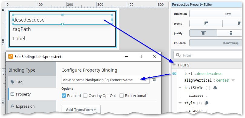

**Post date:** [December 30, 2021, 9:10pm UTC](https://forum.inductiveautomation.com/t/perspective-flex-repeater-cannot-handle-dictionary-input-within-the-instance-parameters/54542/6 "2021-12-30T21:10:40Z")
Yes, the templates are displaying the flex repeater’s _instances.X.Navigation_ values.
 ![Template props binding 3](https://us1.discourse-cdn.com/inductiveautomation/original/3X/e/d/eddb8b4c3eb3d8de0ce0ab291065023af3afa288.png)
Are you sure you have the template bindings set correctly in the view you are repeating?
![Template props binding 4](https://us1.discourse-cdn.com/inductiveautomation/original/3X/c/8/c806c4d36e2b1389ba197b9f41b46097ae0e9fa7.png)
_Label text binding to one of the view.PARAMS._
**Post date:** [December 31, 2021, 8:23am UTC](https://forum.inductiveautomation.com/t/perspective-flex-repeater-cannot-handle-dictionary-input-within-the-instance-parameters/54542/7 "2021-12-31T08:23:07Z")
There was something corrupt with my template. When i did duplicate (delete old) and rename to new. It fixed it… Very strange.
Thank you for your assistance!
