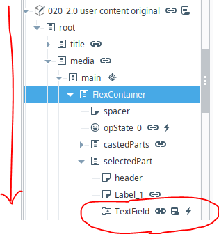

Hello all,
I am trying to gain focus on a component in perspective. My component is sitting inside a nested flex container.
![image](https://us1.discourse-cdn.com/inductiveautomation/original/3X/6/d/6dd8afab6979f8e96c1f184737379a5bf5ed5e38.png)
I tried to supply this code into the startup event of the component itself:
`self.focus()`
did not work, then tried to write the focus command on the root container and the view itself did not work either. Usually this should work but I do not know what I am doing wrong here.
**Author:** ![cmallonee](https://sea1.discourse-cdn.com/inductiveautomation/user_avatar/forum.inductiveautomation.com/cmallonee/32/6416_2.png) [@cmallonee](https://forum.inductiveautomation.com/u/cmallonee)\
**Post date:** [December 3, 2021, 8:39pm UTC](https://forum.inductiveautomation.com/t/perspective-focus/53750/2 "2021-12-03T20:39:20Z")
I don’t know how well applying focus works if a component is moving around. You MIGHT be running into a situation where the component starts up (and therefore fires off its onStartup Event), but the component is then moved around as the flex container grows/shrinks/flexes due to other components. Just out of curiosity, does it work if you wait for 3 seconds before invoking `self.focus()`?
```auto
from time import sleep
sleep(3)
self.focus()
**Author:** ![pkhoshroo](https://sea1.discourse-cdn.com/inductiveautomation/user_avatar/forum.inductiveautomation.com/pkhoshroo/32/26801_2.png) [@pkhoshroo](https://forum.inductiveautomation.com/u/pkhoshroo)\
**Post date:** [December 7, 2021, 2:46pm UTC](https://forum.inductiveautomation.com/t/perspective-focus/53750/3 "2021-12-07T14:46:57Z")
That fixed the issue. Thank you!
