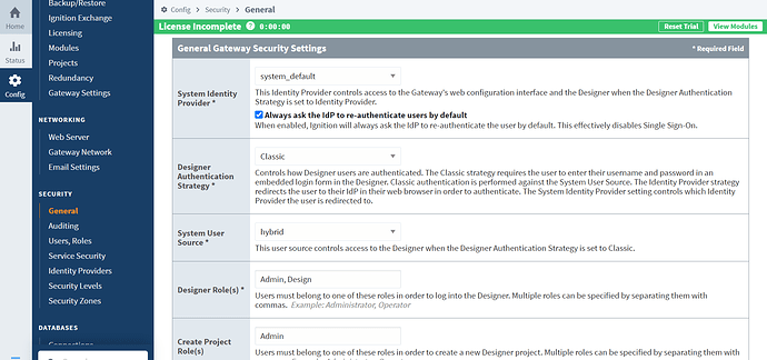

![1.PNG](https://us1.discourse-cdn.com/inductiveautomation/original/3X/d/9/d9b3bea9e1e08757667cf5563fae62b8efc129fc.jpeg)
Hi guys.
I already create the new roles and assign to the particular users but my Ignition only accept Administrators Roles login. When I try to use different roles to access to the system it shows the errors of Access Forbidden. May I know where should I do the settings for this security problems ?

If this is to access the designer or gateway web pages, look at general security section in gateway config section:
 ![image](https://us1.discourse-cdn.com/inductiveautomation/original/3X/5/3/531a388333e3638be8417133099c79b4133fdacb.png)

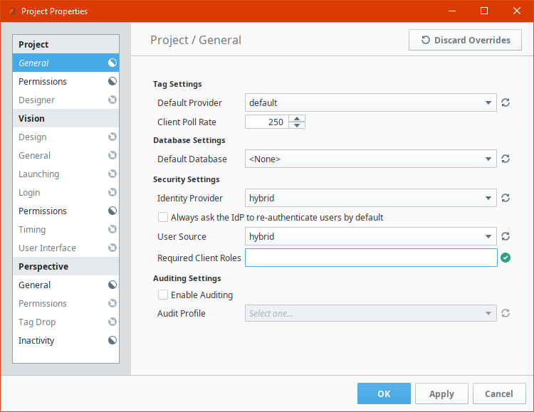

If this is to access Perspective apps, check what roles you’re requiring for them in project properties (in the example shown, anyone can view without logging in, but you could put any of your roles here):
 ![image](https://us1.discourse-cdn.com/inductiveautomation/original/3X/b/5/b552350d76a50052316b3e3dee8930402ea739de.png)
