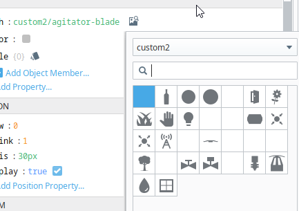

I was working on a tool to smoosh a directory of SVGs into an icon library and I just noticed that the icon browser picks up custom icon libraries 🙂 Very cool! Thanks IA team
![image](https://us1.discourse-cdn.com/inductiveautomation/original/3X/e/b/eb76deb91d6f37ed6ceec666db3148c2221735cf.png)
Not the greatest SVGs to use for icons, but it proves the concept! The blank ones are extra useful
