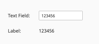

> [@tony.petruzzi1](#):
> Point being that Ignition shouldn’t be comma formatting the number in a text field. It is a bug.
If you bind a label against that `text` property, you'll see that even the displayed Label value does not contain a comma.
If you look at the TextField in an active session (or even in the Designer), you'll see that the TextFIeld does not display the comma.
 ![Screen Shot 2021-05-05 at 1.03.11 PM](https://us1.discourse-cdn.com/inductiveautomation/original/3X/8/8/886b72d5d3d707e6c2543c1f224b78d8c089a367.png)
If you look at the value as it is stored within the view, you'll see that the value does not contain the comma.

The comma AND the warning are only visible in the Designer, and will have no impact on your data either as it is displayed or as it is stored.
At this point you might ask, "well why does it have a warning at all if numbers aren't a problem?"
The answer is that the value of a Text Field must ALWAYS be a string, and so we cast whatever value you supply it to be a string on the backend. The _front-end_ however sees only the characters `123456` and the JSON sort of says "hey, those are numbers" and so it tries to display them as numbers. At this point there's a sort of sort of disconnect which leads to what you're seeing. We can't change the schema to allow for numbers because the value must be a string and will be cast to a string. It is better to err on the side of being informative here in case a user tries to save a float/int value because their value would be changed to a string without warning.
