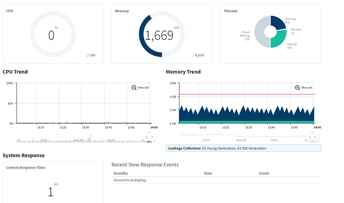

**Post date:** [November 5, 2025, 7:02pm UTC](https://forum.inductiveautomation.com/t/perspective-lock-up/111963/4 "2025-11-05T19:02:35Z")
It is currently locked up and everything looks normal.
 ![image](https://us1.discourse-cdn.com/inductiveautomation/original/3X/8/2/8237c395c529d98bbb53760dbbfc9028c26f7254.png)
**Post date:** [November 5, 2025, 7:28pm UTC](https://forum.inductiveautomation.com/t/perspective-lock-up/111963/5 "2025-11-05T19:28:55Z")
Did you get a thread dump? The screenshot is not helpful.

**Post date:** [November 6, 2025, 2:43pm UTC](https://forum.inductiveautomation.com/t/perspective-lock-up/111963/12 "2025-11-06T14:43:24Z")
Also, that is a deadlock, which is always a bug. IA support will need all of this information to track it down.
