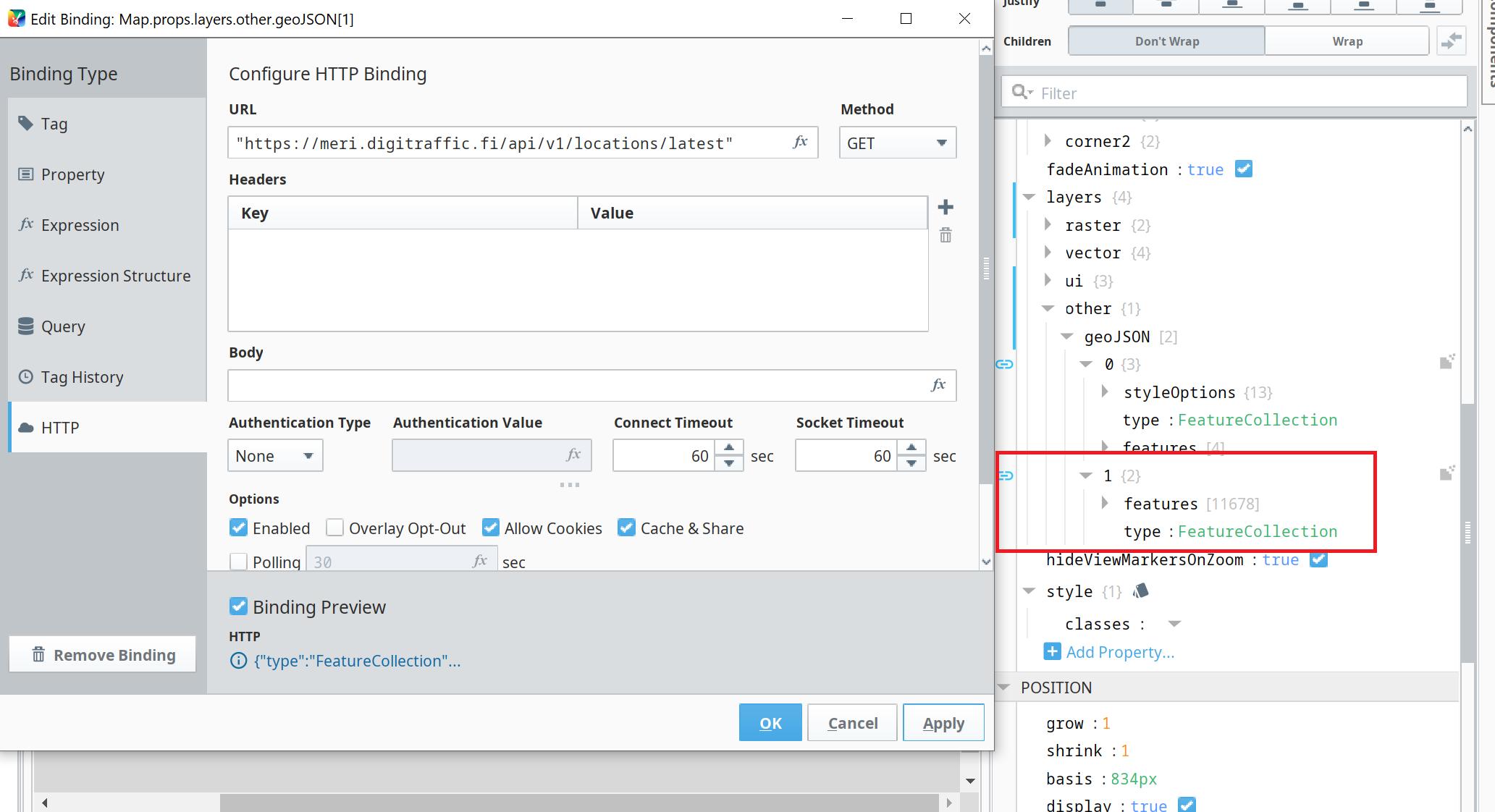

Hi all,
I’m trying to build a project to monitor marine traffic so i tried using the free open-source marine traffic data from [Marine traffic | Digitraffic - Fintraffic](https://www.digitraffic.fi/en/marine-traffic/). I faced serious lag issue in the perspective map when using the browser and even in the designer mode. I believe it might be due to large number of features loaded in the perspective map.
 ![Untitled](https://us1.discourse-cdn.com/inductiveautomation/original/3X/a/f/af65fb2e2fbd6d8d60db613e0fed292ede89648c.png)
I need help to optimise the Perspective map. Would there be a better way to load the marine traffic in the perspective map like what we can see in the [marinetraffic.com](http://marinetraffic.com)?

Are you trying to recreate the [marinetraffic.com](http://marinetraffic.com) map? I think your assumption that it’s the features that are slowing the map down is correct - it looks like it loads all of them, regardless of where they are (whether they will even be displayed or not).
I would look into Marine Traffic’s API and see if there is a way to pass in bounds (the lat and lng of two opposite corners) - I think that would make the map a lot more responsive ([here](https://www.marinetraffic.com/en/ais-api-services/detail/ps06/vessel-positions-in-a-dynamic-bounding-box) is a start). You can use the [Perspective Map’s](https://docs.inductiveautomation.com/display/DOC81/Perspective+-+Map) `getBounds()` method to retrieve the bounds a user is displaying at that moment and then query only the features that would immediately be displayed.
