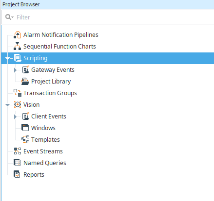

I installed 8.3 and noticed Perspective is missing in the Project Browser. I tried uninstalling and reinstalling and it is still missing. This is purely for testing and not impacting anything, just wondering if anyone else has this issue.

Could you confirm that the Perspective module is showing as installed on the Gateway webpage?
If it is, then can you open the designer console and check for any errors?
Edit: You could also start with checking the designer console since you're already there.

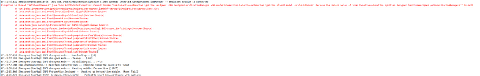

Yes, it is installed and in trial mode. I do see errors in the console.

Can you attach the rest of that log output? The more meaningful log message is probably "Failed to start Browser Engine" and whatever comes after it.

What version of Windows are you using? Any AV software or Windows Defender running?
If it's not an unsupported OS then AV software preventing the Chromium process from being started is often the cause.

Windows 11. I had a later version of 8.1 installed with no issues, this PC is where I do the bulk of my development.
**Post date:** [August 6, 2025, 3:07pm UTC](https://forum.inductiveautomation.com/t/perspective-missing-in-project-browser/109429/8 "2025-08-06T15:07:41Z")
You can try deleting the cache dir in that path and launching again.
JXBrowser / Chromium was upgraded in 8.3, so it's a new executable/signature that may be an issue for the AV software.

I also suspect that something on your machine is preventing the chromium process from running, probably AV.
you can try adding `-Dignition.client.jxBrowser.logLevel=DEBUG` to the [JVM Arguments in the Designer Launcher](https://docs.inductiveautomation.com/docs/8.1/launchers-and-workstation/designer-launcher#designer-general-settings) which should result in more output, however i don't know how much in this scenario as we are dependent on JxBrowser logging for this.
I would definitely look into your AV or security policies related to chromium though
