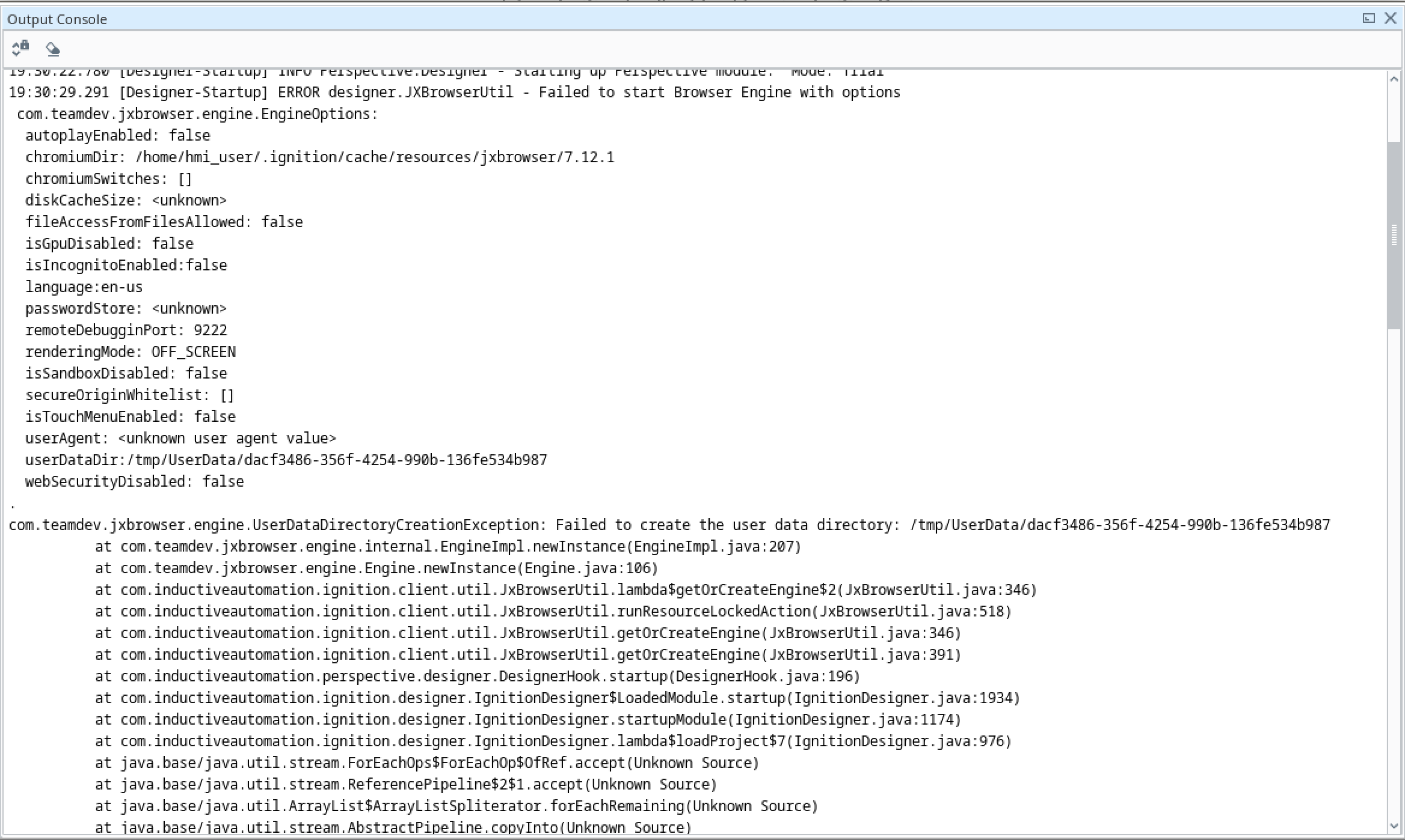

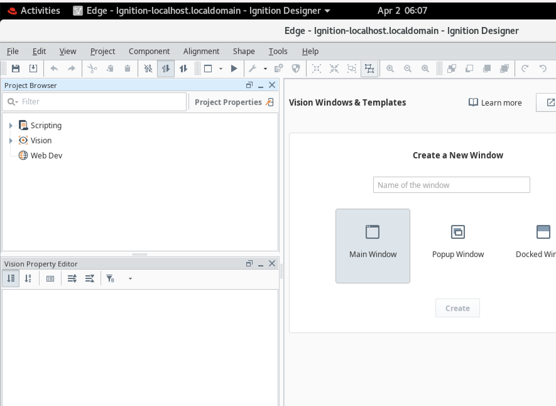

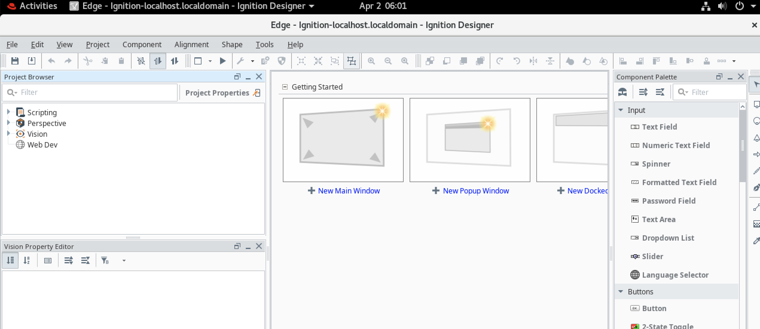

Perspective isn’t showing up in my designer using linux V8.1. Version 8.0.xx worked fine. My server is linux. I can see perspective when using a remote windows pc. Screenshots attached.
V8…1
 ![8.1](https://us1.discourse-cdn.com/inductiveautomation/original/3X/5/6/5612191bfa8eab8682f1be083958ce0d753f01ce.png)
V8.0.17
 ![8.0.17](https://us1.discourse-cdn.com/inductiveautomation/original/3X/4/b/4bf189970d6de84c1cfa9ad20326584acb584c70.png)
This error is showing in the console.
 ![console error](https://us1.discourse-cdn.com/inductiveautomation/original/3X/c/f/cfe71234cae21d5e8805c58cea264052dc16bf81.png)

**Post date:** [April 2, 2021, 10:40pm UTC](https://forum.inductiveautomation.com/t/perspective-not-showing-in-designer-linux-8-1/45227/4 "2021-04-02T22:40:07Z")
Can you paste the entire error message here? Your screenshot is cutting off all of the stack trace.
**Author:** ![chelton](https://avatars.discourse-cdn.com/v4/letter/c/e8c25b/32.png) [@chelton](https://forum.inductiveautomation.com/u/chelton)\
**Post date:** [April 3, 2021, 2:34am UTC](https://forum.inductiveautomation.com/t/perspective-not-showing-in-designer-linux-8-1/45227/5 "2021-04-03T02:34:20Z")
Output Console
 ![Output_console](https://us1.discourse-cdn.com/inductiveautomation/original/3X/8/d/8dcca186501fca160c5085c1849cde442eca9e7c.png)
**Post date:** [April 3, 2021, 2:51pm UTC](https://forum.inductiveautomation.com/t/perspective-not-showing-in-designer-linux-8-1/45227/6 "2021-04-03T14:51:18Z")
Psst! A screenshot is _ **not** _ a “paste”. Highlight the entire text of the error and use Ctrl-C to copy to the clipboard. Paste it into a comment here, then use the “preformatted” button (looks like this \</\>) to make it look right.

```auto

13:52:22.197 [Designer-Startup] ERROR designer.JXBrowserUtil - Failed to start Browser Engine with options
 com.teamdev.jxbrowser.engine.EngineOptions:
  autoplayEnabled: false
  chromiumDir: /home/hmi_user/.ignition/cache/resources/jxbrowser/7.12.1
  chromiumSwitches: []
  diskCacheSize: <unknown>
  fileAccessFromFilesAllowed: false
  isGpuDisabled: false
  isIncognitoEnabled:false
  language:en-us
  passwordStore: <unknown>
  remoteDebugginPort: 9222
  renderingMode: OFF_SCREEN
  isSandboxDisabled: false
  secureOriginWhitelist: []
  isTouchMenuEnabled: false
  userAgent: <unknown user agent value>
  userDataDir:/tmp/UserData/302462ec-de19-40d2-8c74-f41fc2ec0502
  webSecurityDisabled: false
com.teamdev.jxbrowser.engine.UserDataDirectoryCreationException: Failed to create the user data directory: /tmp/UserData/302462ec-de19-40d2-8c74-f41fc2ec0502

Caused by: com.teamdev.jxbrowser.internal.DirectoryCreationException: Failed to create directory: /tmp/UserData/302462ec-de19-40d2-8c74-f41fc2ec0502
	at com.teamdev.jxbrowser.internal.Files.createDirs(Files.java:28)
	at com.teamdev.jxbrowser.engine.internal.EngineImpl.newInstance(EngineImpl.java:200)
	... 21 common frames omitted
Caused by: java.nio.file.AccessDeniedException: /tmp/UserData/302462ec-de19-40d2-8c74-f41fc2ec0502

	at java.base/sun.nio.fs.UnixException.rethrowAsIOException(Unknown Source)
	at java.base/sun.nio.fs.UnixFileSystemProvider.createDirectory(Unknown Source)
	at java.base/java.nio.file.Files.createDirectory(Unknown Source)
	at java.base/java.nio.file.Files.createAndCheckIsDirectory(Unknown Source)
	at java.base/java.nio.file.Files.createDirectories(Unknown Source)
	at com.teamdev.jxbrowser.internal.Files.createDirs(Files.java:26)
	... 23 common frames omitted
13:52:22.983 [Designer-Startup] ERROR WebBrowser - BrowserEngine was not initialized. Web Browser Component can not start!
13:52:23.045 [Designer-Startup] INFO designer.main - Initializing Scripting... [+17485]
13:52:23.172 [Designer-Startup] INFO designer.main - Initializing UI... [+17612]
**Post date:** [April 3, 2021, 9:03pm UTC](https://forum.inductiveautomation.com/t/perspective-not-showing-in-designer-linux-8-1/45227/8 "2021-04-03T21:03:30Z")
Do you have a /tmp folder and does your user have permissions to write to it?
**Post date:** [April 3, 2021, 11:16pm UTC](https://forum.inductiveautomation.com/t/perspective-not-showing-in-designer-linux-8-1/45227/9 "2021-04-03T23:16:58Z")
Hi kevin, Yes have a /tmp directory and can write as user hmi\_user
```auto
[hmi_user@localhost ~]$ df /tmp
Filesystem 1K-blocks Used Available Use% Mounted on
/dev/nvme0n1p3 18555904 15325360 3230544 83% /
[hmi_user@localhost ~]$ ls -ld /tmp
drwxrwxrwt. 42 root root 4096 Apr 3 16:11 /tmp
[hmi_user@localhost ~]$ touch /tmp/test
[hmi_user@localhost ~]$ touch /tmp/test1
[hmi_user@localhost ~]$ ls /tmp/te*
/tmp/test /tmp/test1
**Post date:** [April 3, 2021, 11:37pm UTC](https://forum.inductiveautomation.com/t/perspective-not-showing-in-designer-linux-8-1/45227/10 "2021-04-03T23:37:09Z")
Hmm. Strange. The error seems to be access denied creating `/tmp/UserData/302462ec-de19-40d2-8c74-f41fc2ec0502` but I can’t really see why that would happen.
**Post date:** [April 4, 2021, 12:14am UTC](https://forum.inductiveautomation.com/t/perspective-not-showing-in-designer-linux-8-1/45227/11 "2021-04-04T00:14:37Z")
Console output when running designer as a root user.

**Post date:** [April 4, 2021, 12:17am UTC](https://forum.inductiveautomation.com/t/perspective-not-showing-in-designer-linux-8-1/45227/12 "2021-04-04T00:17:49Z")
Well, it’s a different failure, so it seems there really is some kind of permissions issue with your other user.
I think you’ll have to run this through support so they can try to reproduce it on whatever distro/version you’re using (looks like maybe RHEL?).
