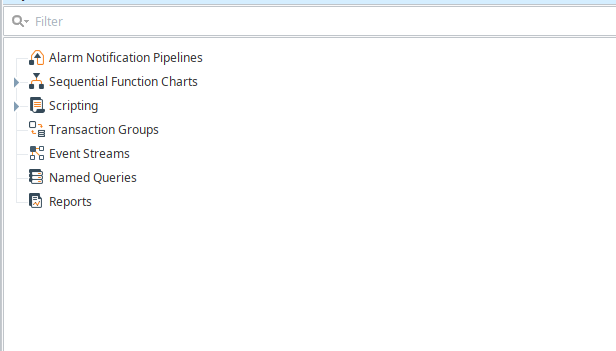

I am not seeing perspective in the property browser
 ![image](https://us1.discourse-cdn.com/inductiveautomation/original/3X/c/f/cfc6ee8e48da2da511e7db045a3ec8cf3c2a1bcc.png)

```python

20:33:03.806 [Designer-Startup] ERROR designer.JXBrowserUtil - Failed to start Browser Engine with options

com.teamdev.jxbrowser.engine.ChromiumProcessStartupFailureException: Process exit code: 0

I tried clearing the cache for jxbrowser but that did not work. I tried to see if copilot would give me anything useful and I don't trust it. The gist of what copilot told is my windows version is Windows 11 Version 25H2 (OS Build 26200.8246)
Which is supposedly a dev build and that is breaking perspective. This is a new PC and I have not really touched perspective on my home automation project because I was working on a django backend.

Do you have any AV or firewall software running? This tends to be the problem. Please see [Perspective Missing in Project Browser - #6 by Kevin.Herron](https://forum.inductiveautomation.com/t/perspective-missing-in-project-browser/109429/6)

Did you delete every jxbrowser directory? If so, you may want to reach out to our support department so they can do a deeper dive into the system [https://support.inductiveautomation.com/hc/en-us](https://support.inductiveautomation.com/hc/en-us)

So I reinstalled the designer and that fixed it. Thank you for your help.
