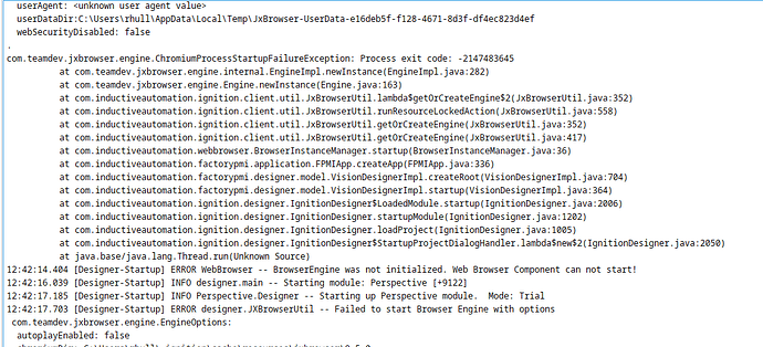

I am trying to test out the new ignition 8.3 beta and I have it on my VM and it works fine there. So now I moved my host’s gateway to 8.3 to see any project conflicts that I might encounter. However, on the host my perspective tab in the project tree is non existent. Is there a way I could get it to appear or a work around for this? Thank You!
Host:
 ![image](https://us1.discourse-cdn.com/inductiveautomation/original/3X/9/5/9543df59ea36cb897b903c77445c966c9c57e1b4.png)

Is the perspective module activated ?

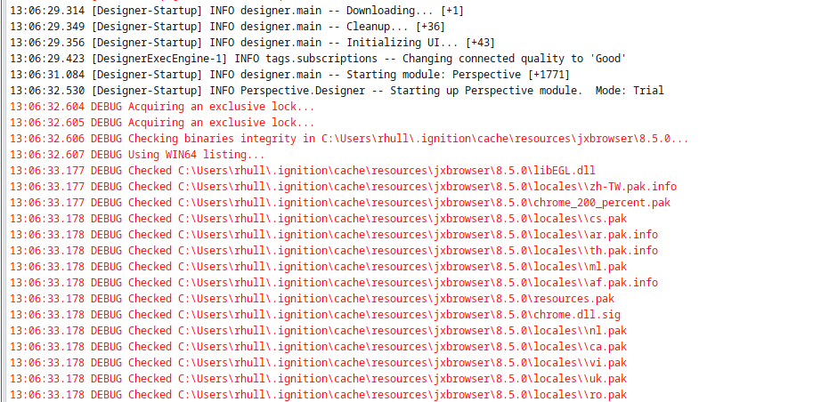

Can you open the console in the Designer and post any errors?
**Author:** ![richhull](https://avatars.discourse-cdn.com/v4/letter/r/b19c9b/32.png) [@richhull](https://forum.inductiveautomation.com/u/richhull)\
**Post date:** [August 19, 2025, 7:52pm UTC](https://forum.inductiveautomation.com/t/perspective-not-showing/109959/4 "2025-08-19T19:52:53Z")
Yes

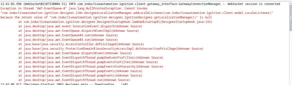

This is the first error I see:
 ![image](https://us1.discourse-cdn.com/inductiveautomation/original/3X/7/6/76ea7c2d47503e37b5f0483ebafdcfd2a0120ea9.png)
**Author:** ![avaughn](https://sea1.discourse-cdn.com/inductiveautomation/user_avatar/forum.inductiveautomation.com/avaughn/32/38972_2.png) [@avaughn](https://forum.inductiveautomation.com/u/avaughn)\
**Post date:** [August 19, 2025, 7:54pm UTC](https://forum.inductiveautomation.com/t/perspective-not-showing/109959/6 "2025-08-19T19:54:54Z")

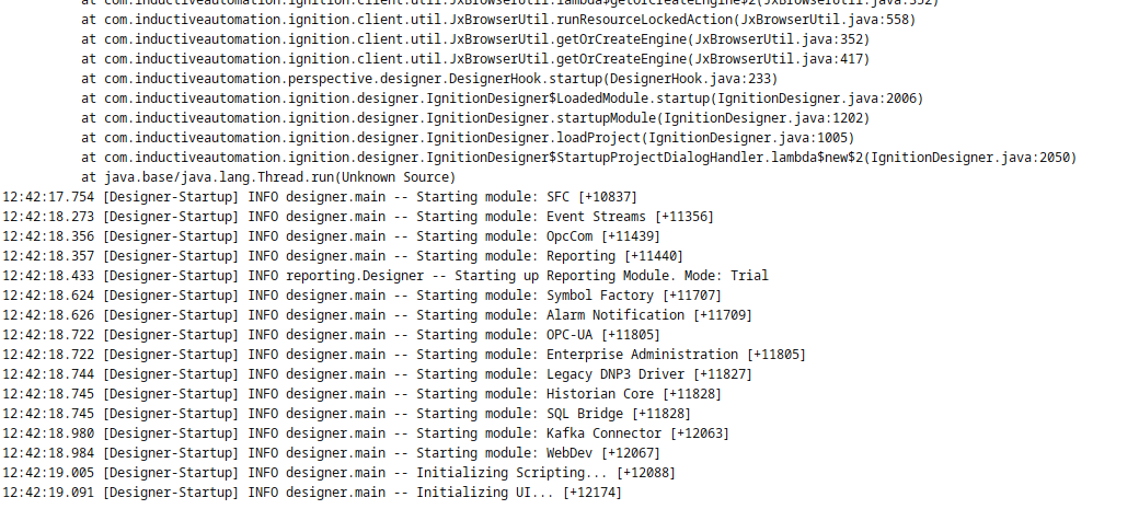

I don’t believe that’s related. Can you post the entirety of the console content after that?
**Post date:** [August 19, 2025, 7:56pm UTC](https://forum.inductiveautomation.com/t/perspective-not-showing/109959/7 "2025-08-19T19:56:28Z")
![image](https://us1.discourse-cdn.com/inductiveautomation/original/3X/a/4/a428603a7c42cc4967c9873bc1432d37f63f90cf.png)
 ![image](https://us1.discourse-cdn.com/inductiveautomation/original/3X/d/c/dc3f328a4a70946842c5cc1cef89db94be5802bc.png)
 ![image](https://us1.discourse-cdn.com/inductiveautomation/original/3X/8/3/83d8a966f04593254186ae128b3493b04910b58a.png)
 ![image](https://us1.discourse-cdn.com/inductiveautomation/original/3X/c/9/c93ed5c2a789582a4784be375e0050661b13de9a.png)

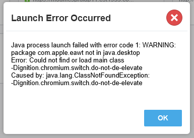

Was the designer launcher opened as an Administrator? If so, can you try reopening it as not an admin
**Post date:** [August 19, 2025, 7:57pm UTC](https://forum.inductiveautomation.com/t/perspective-not-showing/109959/9 "2025-08-19T19:57:38Z")
Let me try that
**Post date:** [August 19, 2025, 7:58pm UTC](https://forum.inductiveautomation.com/t/perspective-not-showing/109959/10 "2025-08-19T19:58:08Z")
Just edited my last message, but make sure it’s not opened as admin
**Post date:** [August 19, 2025, 7:59pm UTC](https://forum.inductiveautomation.com/t/perspective-not-showing/109959/11 "2025-08-19T19:59:11Z")
Oh it was originally not opened as admin. I just opened it as an admin and got the same problem. Back to no longer running as admin

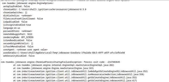

Can you try increasing the logging level and re-launching as mentioned in this other thread.
> [@Perspective Missing in Project Browser](https://forum.inductiveautomation.com/t/perspective-missing-in-project-browser/109429/10):
> I also suspect that something on your machine is preventing the chromium process from running, probably AV. you can try adding -Dignition.client.jxBrowser.logLevel=DEBUG to the [JVM Arguments in the Designer Launcher](https://docs.inductiveautomation.com/docs/8.1/launchers-and-workstation/designer-launcher#designer-general-settings) which should result in more output, however i don't know how much in this scenario as we are dependent on JxBrowser logging for this. I would definitely look into your AV or security policies related to chromium though
**Post date:** [August 19, 2025, 8:07pm UTC](https://forum.inductiveautomation.com/t/perspective-not-showing/109959/13 "2025-08-19T20:07:46Z")
I got a whole bunch of errors
 ![image](https://us1.discourse-cdn.com/inductiveautomation/original/3X/7/a/7a62bed624f72ee87412a5f7ae4640349ef7c598.png)
**Post date:** [August 19, 2025, 8:08pm UTC](https://forum.inductiveautomation.com/t/perspective-not-showing/109959/14 "2025-08-19T20:08:51Z")
Can you copy the text and paste it here as preformatted text?

13:06:34.067 DEBUG Checked C:\Users\rhull\.ignition\cache\resources\jxbrowser\8.5.0\locales\\ca.pak.info
13:06:34.067 DEBUG Checked C:\Users\rhull\.ignition\cache\resources\jxbrowser\8.5.0\locales\\pl.pak.info
13:06:34.067 DEBUG Checked C:\Users\rhull\.ignition\cache\resources\jxbrowser\8.5.0\locales\\fil.pak
13:06:34.067 DEBUG Checked C:\Users\rhull\.ignition\cache\resources\jxbrowser\8.5.0\locales\\de.pak
13:06:34.068 DEBUG Checked C:\Users\rhull\.ignition\cache\resources\jxbrowser\8.5.0\locales\\lt.pak
13:06:34.068 DEBUG Checked C:\Users\rhull\.ignition\cache\resources\jxbrowser\8.5.0\locales\\ml.pak.info
13:06:34.068 DEBUG Checked C:\Users\rhull\.ignition\cache\resources\jxbrowser\8.5.0\locales\\zh-TW.pak
13:06:34.068 DEBUG Checked C:\Users\rhull\.ignition\cache\resources\jxbrowser\8.5.0\locales\\it.pak
13:06:34.068 DEBUG Checked C:\Users\rhull\.ignition\cache\resources\jxbrowser\8.5.0\locales\\fa.pak.info
13:06:34.068 DEBUG Checked C:\Users\rhull\.ignition\cache\resources\jxbrowser\8.5.0\chrome.dll
13:06:34.068 DEBUG Checked C:\Users\rhull\.ignition\cache\resources\jxbrowser\8.5.0\locales\\am.pak
13:06:34.068 DEBUG Checked C:\Users\rhull\.ignition\cache\resources\jxbrowser\8.5.0\awt_toolkit32.dll
13:06:34.068 DEBUG Checked C:\Users\rhull\.ignition\cache\resources\jxbrowser\8.5.0\locales\\sl.pak.info
13:06:34.068 DEBUG Checked C:\Users\rhull\.ignition\cache\resources\jxbrowser\8.5.0\locales\\hu.pak
13:06:34.068 DEBUG Checked C:\Users\rhull\.ignition\cache\resources\jxbrowser\8.5.0\locales\\sr.pak.info
13:06:34.069 DEBUG Checked C:\Users\rhull\.ignition\cache\resources\jxbrowser\8.5.0\locales\\ta.pak
13:06:34.069 DEBUG Checked C:\Users\rhull\.ignition\cache\resources\jxbrowser\8.5.0\locales\\el.pak.info
13:06:34.069 DEBUG Checked C:\Users\rhull\.ignition\cache\resources\jxbrowser\8.5.0\locales\\sl.pak
13:06:34.069 DEBUG Checked C:\Users\rhull\.ignition\cache\resources\jxbrowser\8.5.0\locales\\en-GB.pak
13:06:34.069 DEBUG Checked C:\Users\rhull\.ignition\cache\resources\jxbrowser\8.5.0\ipc32.dll
13:06:34.069 DEBUG Checked C:\Users\rhull\.ignition\cache\resources\jxbrowser\8.5.0\locales\\hi.pak.info
13:06:34.069 DEBUG Checked C:\Users\rhull\.ignition\cache\resources\jxbrowser\8.5.0\locales\\nb.pak
13:06:34.069 DEBUG Checked C:\Users\rhull\.ignition\cache\resources\jxbrowser\8.5.0\locales\\sw.pak
13:06:34.069 DEBUG Checked C:\Users\rhull\.ignition\cache\resources\jxbrowser\8.5.0\locales\\te.pak.info
13:06:34.069 DEBUG Checked C:\Users\rhull\.ignition\cache\resources\jxbrowser\8.5.0\locales\\cs.pak.info
13:06:34.069 DEBUG Checked C:\Users\rhull\.ignition\cache\resources\jxbrowser\8.5.0\locales\\ko.pak
13:06:34.070 DEBUG Checked C:\Users\rhull\.ignition\cache\resources\jxbrowser\8.5.0\locales\\vi.pak.info
13:06:34.070 DEBUG Checked C:\Users\rhull\.ignition\cache\resources\jxbrowser\8.5.0\locales\\gu.pak
13:06:34.070 DEBUG Checked C:\Users\rhull\.ignition\cache\resources\jxbrowser\8.5.0\toolkit64.dll
13:06:34.070 DEBUG Checked C:\Users\rhull\.ignition\cache\resources\jxbrowser\8.5.0\locales\\uk.pak.info
13:06:34.070 DEBUG Checked C:\Users\rhull\.ignition\cache\resources\jxbrowser\8.5.0\locales\\pt-PT.pak.info
13:06:34.070 DEBUG Checked C:\Users\rhull\.ignition\cache\resources\jxbrowser\8.5.0\d3dcompiler_47.dll
13:06:34.070 DEBUG Checked C:\Users\rhull\.ignition\cache\resources\jxbrowser\8.5.0\locales\\es-419.pak
13:06:34.070 DEBUG Checked C:\Users\rhull\.ignition\cache\resources\jxbrowser\8.5.0\locales\\ja.pak
13:06:34.070 DEBUG Checked C:\Users\rhull\.ignition\cache\resources\jxbrowser\8.5.0\locales\\it.pak.info
13:06:34.070 DEBUG Checked C:\Users\rhull\.ignition\cache\resources\jxbrowser\8.5.0\134.0.6998.89.manifest
13:06:34.070 DEBUG Checked C:\Users\rhull\.ignition\cache\resources\jxbrowser\8.5.0\locales\\da.pak.info
13:06:34.070 DEBUG Checked C:\Users\rhull\.ignition\cache\resources\jxbrowser\8.5.0\locales\\gu.pak.info
13:06:34.071 DEBUG Checked C:\Users\rhull\.ignition\cache\resources\jxbrowser\8.5.0\locales\\te.pak
13:06:34.071 DEBUG Checked C:\Users\rhull\.ignition\cache\resources\jxbrowser\8.5.0\locales\\he.pak
13:06:34.071 DEBUG Checked C:\Users\rhull\.ignition\cache\resources\jxbrowser\8.5.0\locales\\bn.pak.info
13:06:34.071 DEBUG Checked C:\Users\rhull\.ignition\cache\resources\jxbrowser\8.5.0\locales\\pt-BR.pak.info
13:06:34.071 DEBUG Checked C:\Users\rhull\.ignition\cache\resources\jxbrowser\8.5.0\chromium.exe
13:06:34.071 DEBUG Checked C:\Users\rhull\.ignition\cache\resources\jxbrowser\8.5.0\chrome_elf.dll
13:06:34.071 DEBUG Checked C:\Users\rhull\.ignition\cache\resources\jxbrowser\8.5.0\locales\\ur.pak.info
13:06:34.071 DEBUG Checked C:\Users\rhull\.ignition\cache\resources\jxbrowser\8.5.0\locales\\zh-CN.pak
13:06:34.071 DEBUG Checked C:\Users\rhull\.ignition\cache\resources\jxbrowser\8.5.0\locales\\de.pak.info
13:06:34.072 DEBUG Checked C:\Users\rhull\.ignition\cache\resources\jxbrowser\8.5.0\locales\\fil.pak.info
13:06:34.072 DEBUG Checked C:\Users\rhull\.ignition\cache\resources\jxbrowser\8.5.0\locales\\bg.pak
13:06:34.072 DEBUG Checked C:\Users\rhull\.ignition\cache\resources\jxbrowser\8.5.0\locales\\es.pak.info
13:06:34.072 DEBUG Checked C:\Users\rhull\.ignition\cache\resources\jxbrowser\8.5.0\locales\\et.pak
13:06:34.072 DEBUG Checked C:\Users\rhull\.ignition\cache\resources\jxbrowser\8.5.0\locales\\sw.pak.info
13:06:34.072 DEBUG Checked C:\Users\rhull\.ignition\cache\resources\jxbrowser\8.5.0\vk_swiftshader.dll
13:06:34.072 DEBUG Checked C:\Users\rhull\.ignition\cache\resources\jxbrowser\8.5.0\locales\\nl.pak.info
13:06:34.072 DEBUG Checked C:\Users\rhull\.ignition\cache\resources\jxbrowser\8.5.0\locales\\pt-BR.pak
13:06:34.072 DEBUG Checked C:\Users\rhull\.ignition\cache\resources\jxbrowser\8.5.0\locales\\fa.pak
13:06:34.072 DEBUG Checked C:\Users\rhull\.ignition\cache\resources\jxbrowser\8.5.0\locales\\lt.pak.info
13:06:34.073 DEBUG Checked C:\Users\rhull\.ignition\cache\resources\jxbrowser\8.5.0\locales\\af.pak
13:06:34.073 DEBUG Checked C:\Users\rhull\.ignition\cache\resources\jxbrowser\8.5.0\locales\\hi.pak
13:06:34.073 DEBUG Checked C:\Users\rhull\.ignition\cache\resources\jxbrowser\8.5.0\chrome_100_percent.pak
13:06:34.073 DEBUG Checked C:\Users\rhull\.ignition\cache\resources\jxbrowser\8.5.0\locales\\nb.pak.info
13:06:34.073 DEBUG Checked C:\Users\rhull\.ignition\cache\resources\jxbrowser\8.5.0\icudtl.dat
13:06:34.073 DEBUG Checked C:\Users\rhull\.ignition\cache\resources\jxbrowser\8.5.0\locales\\mr.pak.info
13:06:34.073 DEBUG Checked C:\Users\rhull\.ignition\cache\resources\jxbrowser\8.5.0\v8_context_snapshot.bin
13:06:34.073 DEBUG Checked C:\Users\rhull\.ignition\cache\resources\jxbrowser\8.5.0\locales\\tr.pak
13:06:34.073 DEBUG Checked C:\Users\rhull\.ignition\cache\resources\jxbrowser\8.5.0\locales\\ja.pak.info
13:06:34.073 DEBUG Checked C:\Users\rhull\.ignition\cache\resources\jxbrowser\8.5.0\locales\\hr.pak
13:06:34.073 DEBUG Checked C:\Users\rhull\.ignition\cache\resources\jxbrowser\8.5.0\locales\\lv.pak.info
13:06:34.073 DEBUG Checked C:\Users\rhull\.ignition\cache\resources\jxbrowser\8.5.0\locales\\hu.pak.info
13:06:34.073 DEBUG Checked C:\Users\rhull\.ignition\cache\resources\jxbrowser\8.5.0\locales\\sk.pak.info
13:06:34.073 DEBUG Checked C:\Users\rhull\.ignition\cache\resources\jxbrowser\8.5.0\locales\\kn.pak.info
13:06:34.073 DEBUG Checked C:\Users\rhull\.ignition\cache\resources\jxbrowser\8.5.0\locales\\ro.pak.info
13:06:34.073 DEBUG Checked C:\Users\rhull\.ignition\cache\resources\jxbrowser\8.5.0\locales\\zh-CN.pak.info
13:06:34.073 DEBUG Checked C:\Users\rhull\.ignition\cache\resources\jxbrowser\8.5.0\locales\\ru.pak
13:06:34.077 DEBUG Checking binaries integrity... [OK]
13:06:34.078 DEBUG Releasing the exclusive lock...
13:06:34.078 DEBUG Starting server...
13:06:34.078 DEBUG Starting server at port 62753... [OK]
13:06:34.079 DEBUG Accepting connections...
13:06:34.080 DEBUG Starting chromium process...
13:06:34.080 DEBUG __COMPAT_LAYER variable detected: ElevateCreateProcess
13:06:34.080 DEBUG C:\Users\rhull\.ignition\cache\resources\jxbrowser\8.5.0\chromium.exe --port=62753 --pid=26628 --browsercore --no-default-browser-check --off-screen --lang=en-us --remote-debugging-port=9222 --hung-render-delay-seconds=15 --incognito --proprietary-features=0 --user-data-dir=C:\Users\rhull\AppData\Local\Temp\JxBrowser-UserData-37c14d4e-6c99-45c0-a10a-7c610975aea9 --dpi-awareness=per-monitor-aware --disable-fill-background --disable-direct-composition --crash-dump-dir=C:\Users\rhull\AppData\Local\JxBrowser\8.5.0\CrashReports --disable-background-networking --disable-sync --disable-features=OptimizationHintsFetching --disable-component-update
13:06:34.087 DEBUG Starting chromium process... [OK]
13:06:34.206 DEBUG [Chromium] [0819/130634.206:INFO:compatibility_mode.cc(86)] Actual Windows version: 10.0.26100
13:06:34.206 DEBUG [Chromium] [0819/130634.206:INFO:compatibility_mode.cc(93)] Simulated Windows version: 10.0.26100
13:06:34.206 DEBUG [Chromium] [0819/130634.206:INFO:compatibility_mode.cc(62)] Compatibility environment variable: ElevateCreateProcess
13:06:34.244 DEBUG Accepting connection...
13:06:34.245 DEBUG RPC thread started: id = 109, type = BROWSER
13:06:34.245 DEBUG Product binding call stack:
java.lang.Thread
com.teamdev.jxbrowser.engine.internal.EngineImpl
com.teamdev.jxbrowser.engine.Engine
com.inductiveautomation.ignition.client.util.JxBrowserUtil
com.inductiveautomation.webbrowser.BrowserInstanceManager
com.inductiveautomation.factorypmi.application.FPMIApp
com.inductiveautomation.factorypmi.designer.model.VisionDesignerImpl
com.inductiveautomation.ignition.designer.IgnitionDesigner$LoadedModule
com.inductiveautomation.ignition.designer.IgnitionDesigner$StartupProjectDialogHandler
java.lang.Thread
13:06:34.245 DEBUG Accepted: RpcConnection [id = 81300e76-7373-457d-af3b-16149e523344; type = BROWSER]
13:06:34.245 DEBUG > [2:69]: rpc.EngineFactory.ApplyLicense [product_name: "JxBrowser" product_version: "8.5.0" stack_trace: *****key:*****]
13:06:34.279 DEBUG [Chromium] [30596:7844:0819/130634.279:WARNING:account_consistency_mode_manager.cc(77)] Desktop Identity Consistency cannot be enabled as no OAuth client ID and client secret have been configured.
13:06:34.322 DEBUG Accepting connection...
13:06:34.323 DEBUG RPC thread started: id = 112, type = NETWORK_SERVICE
13:06:34.324 DEBUG Accepted: RpcConnection [id = 56c2740e-d80e-401d-8ec0-f03ac8cc768e; type = NETWORK_SERVICE]
13:06:34.410 DEBUG [Chromium] [24864:9192:0819/130634.410:WARNING:viz_main_impl.cc(85)] VizNullHypothesis is disabled (not a warning)
13:06:34.410 DEBUG [Chromium] [24864:9192:0819/130634.410:INFO:content_gpu_client.cc(47)] ContentGpuClient::PostCompositorThreadCreated
13:06:34.516 DEBUG Chromium process exit code: -2,147,483,645
13:06:34.533 DEBUG Closing RPC thread...
13:06:34.533 DEBUG The connection has been terminated.
13:06:34.533 DEBUG Closing RPC thread... [OK]
13:06:34.562 DEBUG Stopping server...
13:06:34.562 DEBUG Stopping server... [OK]
**Post date:** [August 19, 2025, 8:10pm UTC](https://forum.inductiveautomation.com/t/perspective-not-showing/109959/16 "2025-08-19T20:10:46Z")
Perspective:
```python
13:06:31.084 [Designer-Startup] INFO designer.main -- Starting module: Perspective [+1771]
13:06:32.530 [Designer-Startup] INFO Perspective.Designer -- Starting up Perspective module. Mode: Trial
13:06:32.604 DEBUG Acquiring an exclusive lock...
13:06:32.605 DEBUG Acquiring an exclusive lock...
13:06:32.606 DEBUG Checking binaries integrity in C:\Users\rhull\.ignition\cache\resources\jxbrowser\8.5.0...
13:06:32.607 DEBUG Using WIN64 listing...
13:06:33.177 DEBUG Checked C:\Users\rhull\.ignition\cache\resources\jxbrowser\8.5.0\libEGL.dll
13:06:33.177 DEBUG Checked C:\Users\rhull\.ignition\cache\resources\jxbrowser\8.5.0\locales\\zh-TW.pak.info
13:06:33.177 DEBUG Checked C:\Users\rhull\.ignition\cache\resources\jxbrowser\8.5.0\chrome_200_percent.pak
13:06:33.178 DEBUG Checked C:\Users\rhull\.ignition\cache\resources\jxbrowser\8.5.0\locales\\cs.pak
13:06:33.178 DEBUG Checked C:\Users\rhull\.ignition\cache\resources\jxbrowser\8.5.0\locales\\ar.pak.info
13:06:33.178 DEBUG Checked C:\Users\rhull\.ignition\cache\resources\jxbrowser\8.5.0\locales\\th.pak.info
13:06:33.178 DEBUG Checked C:\Users\rhull\.ignition\cache\resources\jxbrowser\8.5.0\locales\\ml.pak
13:06:33.178 DEBUG Checked C:\Users\rhull\.ignition\cache\resources\jxbrowser\8.5.0\locales\\af.pak.info
13:06:33.178 DEBUG Checked C:\Users\rhull\.ignition\cache\resources\jxbrowser\8.5.0\resources.pak
13:06:33.178 DEBUG Checked C:\Users\rhull\.ignition\cache\resources\jxbrowser\8.5.0\chrome.dll.sig
13:06:33.178 DEBUG Checked C:\Users\rhull\.ignition\cache\resources\jxbrowser\8.5.0\locales\\nl.pak
13:06:33.178 DEBUG Checked C:\Users\rhull\.ignition\cache\resources\jxbrowser\8.5.0\locales\\ca.pak
13:06:33.178 DEBUG Checked C:\Users\rhull\.ignition\cache\resources\jxbrowser\8.5.0\locales\\vi.pak
13:06:33.178 DEBUG Checked C:\Users\rhull\.ignition\cache\resources\jxbrowser\8.5.0\locales\\uk.pak
13:06:33.178 DEBUG Checked C:\Users\rhull\.ignition\cache\resources\jxbrowser\8.5.0\locales\\ro.pak
13:06:33.178 DEBUG Checked C:\Users\rhull\.ignition\cache\resources\jxbrowser\8.5.0\locales\\en-US.pak
13:06:33.179 DEBUG Checked C:\Users\rhull\.ignition\cache\resources\jxbrowser\8.5.0\locales\\sv.pak
13:06:33.179 DEBUG Checked C:\Users\rhull\.ignition\cache\resources\jxbrowser\8.5.0\awt_toolkit64.dll
13:06:33.179 DEBUG Checked C:\Users\rhull\.ignition\cache\resources\jxbrowser\8.5.0\locales\\bn.pak
13:06:33.179 DEBUG Checked C:\Users\rhull\.ignition\cache\resources\jxbrowser\8.5.0\locales\\da.pak
13:06:33.179 DEBUG Checked C:\Users\rhull\.ignition\cache\resources\jxbrowser\8.5.0\MEIPreload\\manifest.json
13:06:33.179 DEBUG Checked C:\Users\rhull\.ignition\cache\resources\jxbrowser\8.5.0\libGLESv2.dll
13:06:33.180 DEBUG Checked C:\Users\rhull\.ignition\cache\resources\jxbrowser\8.5.0\toolkit32.dll
13:06:33.180 DEBUG Checked C:\Users\rhull\.ignition\cache\resources\jxbrowser\8.5.0\locales\\pt-PT.pak
13:06:33.180 DEBUG Checked C:\Users\rhull\.ignition\cache\resources\jxbrowser\8.5.0\locales\\kn.pak
13:06:33.180 DEBUG Checked C:\Users\rhull\.ignition\cache\resources\jxbrowser\8.5.0\MEIPreload\\preloaded_data.pb
13:06:33.180 DEBUG Checked C:\Users\rhull\.ignition\cache\resources\jxbrowser\8.5.0\locales\\am.pak.info
13:06:33.180 DEBUG Checked C:\Users\rhull\.ignition\cache\resources\jxbrowser\8.5.0\chromium.version
13:06:33.180 DEBUG Checked C:\Users\rhull\.ignition\cache\resources\jxbrowser\8.5.0\locales\\ms.pak
13:06:33.180 DEBUG Checked C:\Users\rhull\.ignition\cache\resources\jxbrowser\8.5.0\locales\\ur.pak
13:06:33.180 DEBUG Checked C:\Users\rhull\.ignition\cache\resources\jxbrowser\8.5.0\locales\\sk.pak
13:06:33.180 DEBUG Checked C:\Users\rhull\.ignition\cache\resources\jxbrowser\8.5.0\locales\\hr.pak.info
13:06:33.180 DEBUG Checked C:\Users\rhull\.ignition\cache\resources\jxbrowser\8.5.0\locales\\fi.pak.info
13:06:33.180 DEBUG Checked C:\Users\rhull\.ignition\cache\resources\jxbrowser\8.5.0\locales\\ar.pak
13:06:33.182 DEBUG Checked C:\Users\rhull\.ignition\cache\resources\jxbrowser\8.5.0\locales\\id.pak.info
13:06:33.182 DEBUG Checked C:\Users\rhull\.ignition\cache\resources\jxbrowser\8.5.0\locales\\es-419.pak.info
13:06:33.182 DEBUG Checked C:\Users\rhull\.ignition\cache\resources\jxbrowser\8.5.0\locales\\pl.pak
13:06:33.182 DEBUG Checked C:\Users\rhull\.ignition\cache\resources\jxbrowser\8.5.0\locales\\el.pak
13:06:33.182 DEBUG Checked C:\Users\rhull\.ignition\cache\resources\jxbrowser\8.5.0\locales\\he.pak.info
13:06:33.182 DEBUG Checked C:\Users\rhull\.ignition\cache\resources\jxbrowser\8.5.0\locales\\mr.pak
13:06:33.182 DEBUG Checked C:\Users\rhull\.ignition\cache\resources\jxbrowser\8.5.0\locales\\ta.pak.info
13:06:33.182 DEBUG Checked C:\Users\rhull\.ignition\cache\resources\jxbrowser\8.5.0\locales\\ms.pak.info
13:06:33.182 DEBUG Checked C:\Users\rhull\.ignition\cache\resources\jxbrowser\8.5.0\vulkan-1.dll
13:06:33.182 DEBUG Checked C:\Users\rhull\.ignition\cache\resources\jxbrowser\8.5.0\locales\\bg.pak.info
13:06:33.182 DEBUG Checked C:\Users\rhull\.ignition\cache\resources\jxbrowser\8.5.0\locales\\fi.pak
13:06:33.182 DEBUG Checked C:\Users\rhull\.ignition\cache\resources\jxbrowser\8.5.0\locales\\sr.pak
13:06:33.182 DEBUG Checked C:\Users\rhull\.ignition\cache\resources\jxbrowser\8.5.0\locales\\es.pak
13:06:33.182 DEBUG Checked C:\Users\rhull\.ignition\cache\resources\jxbrowser\8.5.0\locales\\fr.pak
13:06:33.182 DEBUG Checked C:\Users\rhull\.ignition\cache\resources\jxbrowser\8.5.0\locales\\th.pak
13:06:33.182 DEBUG Checked C:\Users\rhull\.ignition\cache\resources\jxbrowser\8.5.0\locales\\tr.pak.info
13:06:33.184 DEBUG Checked C:\Users\rhull\.ignition\cache\resources\jxbrowser\8.5.0\locales\\en-US.pak.info
13:06:33.184 DEBUG Checked C:\Users\rhull\.ignition\cache\resources\jxbrowser\8.5.0\locales\\et.pak.info
13:06:33.184 DEBUG Checked C:\Users\rhull\.ignition\cache\resources\jxbrowser\8.5.0\locales\\lv.pak
13:06:33.184 DEBUG Checked C:\Users\rhull\.ignition\cache\resources\jxbrowser\8.5.0\locales\\sv.pak.info
13:06:33.184 DEBUG Checked C:\Users\rhull\.ignition\cache\resources\jxbrowser\8.5.0\ipc64.dll
13:06:33.184 DEBUG Checked C:\Users\rhull\.ignition\cache\resources\jxbrowser\8.5.0\chromium.exe.sig
13:06:33.184 DEBUG Checked C:\Users\rhull\.ignition\cache\resources\jxbrowser\8.5.0\locales\\en-GB.pak.info
13:06:33.184 DEBUG Checked C:\Users\rhull\.ignition\cache\resources\jxbrowser\8.5.0\vk_swiftshader_icd.json
13:06:33.184 DEBUG Checked C:\Users\rhull\.ignition\cache\resources\jxbrowser\8.5.0\locales\\ru.pak.info
13:06:33.185 DEBUG Checked C:\Users\rhull\.ignition\cache\resources\jxbrowser\8.5.0\locales\\fr.pak.info
13:06:33.185 DEBUG Checked C:\Users\rhull\.ignition\cache\resources\jxbrowser\8.5.0\locales\\ko.pak.info
13:06:33.185 DEBUG Checked C:\Users\rhull\.ignition\cache\resources\jxbrowser\8.5.0\locales\\ca.pak.info
13:06:33.185 DEBUG Checked C:\Users\rhull\.ignition\cache\resources\jxbrowser\8.5.0\locales\\pl.pak.info
13:06:33.185 DEBUG Checked C:\Users\rhull\.ignition\cache\resources\jxbrowser\8.5.0\locales\\fil.pak
13:06:33.185 DEBUG Checked C:\Users\rhull\.ignition\cache\resources\jxbrowser\8.5.0\locales\\de.pak
13:06:33.185 DEBUG Checked C:\Users\rhull\.ignition\cache\resources\jxbrowser\8.5.0\locales\\lt.pak
13:06:33.185 DEBUG Checked C:\Users\rhull\.ignition\cache\resources\jxbrowser\8.5.0\locales\\ml.pak.info
13:06:33.185 DEBUG Checked C:\Users\rhull\.ignition\cache\resources\jxbrowser\8.5.0\locales\\zh-TW.pak
13:06:33.185 DEBUG Checked C:\Users\rhull\.ignition\cache\resources\jxbrowser\8.5.0\locales\\it.pak
13:06:33.186 DEBUG Checked C:\Users\rhull\.ignition\cache\resources\jxbrowser\8.5.0\locales\\fa.pak.info
13:06:33.186 DEBUG Checked C:\Users\rhull\.ignition\cache\resources\jxbrowser\8.5.0\chrome.dll
13:06:33.186 DEBUG Checked C:\Users\rhull\.ignition\cache\resources\jxbrowser\8.5.0\locales\\am.pak
13:06:33.186 DEBUG Checked C:\Users\rhull\.ignition\cache\resources\jxbrowser\8.5.0\awt_toolkit32.dll
13:06:33.186 DEBUG Checked C:\Users\rhull\.ignition\cache\resources\jxbrowser\8.5.0\locales\\sl.pak.info
13:06:33.186 DEBUG Checked C:\Users\rhull\.ignition\cache\resources\jxbrowser\8.5.0\locales\\hu.pak
13:06:33.186 DEBUG Checked C:\Users\rhull\.ignition\cache\resources\jxbrowser\8.5.0\locales\\sr.pak.info
13:06:33.186 DEBUG Checked C:\Users\rhull\.ignition\cache\resources\jxbrowser\8.5.0\locales\\ta.pak
13:06:33.186 DEBUG Checked C:\Users\rhull\.ignition\cache\resources\jxbrowser\8.5.0\locales\\el.pak.info
13:06:33.188 DEBUG Checked C:\Users\rhull\.ignition\cache\resources\jxbrowser\8.5.0\locales\\en-GB.pak
13:06:33.188 DEBUG Checked C:\Users\rhull\.ignition\cache\resources\jxbrowser\8.5.0\ipc32.dll
13:06:33.188 DEBUG Checked C:\Users\rhull\.ignition\cache\resources\jxbrowser\8.5.0\locales\\hi.pak.info
13:06:33.188 DEBUG Checked C:\Users\rhull\.ignition\cache\resources\jxbrowser\8.5.0\locales\\nb.pak
13:06:33.188 DEBUG Checked C:\Users\rhull\.ignition\cache\resources\jxbrowser\8.5.0\locales\\sw.pak
13:06:33.188 DEBUG Checked C:\Users\rhull\.ignition\cache\resources\jxbrowser\8.5.0\locales\\te.pak.info
13:06:33.188 DEBUG Checked C:\Users\rhull\.ignition\cache\resources\jxbrowser\8.5.0\locales\\cs.pak.info
13:06:33.188 DEBUG Checked C:\Users\rhull\.ignition\cache\resources\jxbrowser\8.5.0\locales\\ko.pak
13:06:33.188 DEBUG Checked C:\Users\rhull\.ignition\cache\resources\jxbrowser\8.5.0\locales\\vi.pak.info
13:06:33.188 DEBUG Checked C:\Users\rhull\.ignition\cache\resources\jxbrowser\8.5.0\locales\\gu.pak
13:06:33.188 DEBUG Checked C:\Users\rhull\.ignition\cache\resources\jxbrowser\8.5.0\toolkit64.dll
13:06:33.188 DEBUG Checked C:\Users\rhull\.ignition\cache\resources\jxbrowser\8.5.0\locales\\uk.pak.info
13:06:33.189 DEBUG Checked C:\Users\rhull\.ignition\cache\resources\jxbrowser\8.5.0\locales\\pt-PT.pak.info
13:06:33.189 DEBUG Checked C:\Users\rhull\.ignition\cache\resources\jxbrowser\8.5.0\d3dcompiler_47.dll
13:06:33.189 DEBUG Checked C:\Users\rhull\.ignition\cache\resources\jxbrowser\8.5.0\locales\\es-419.pak
13:06:33.189 DEBUG Checked C:\Users\rhull\.ignition\cache\resources\jxbrowser\8.5.0\locales\\ja.pak
13:06:33.189 DEBUG Checked C:\Users\rhull\.ignition\cache\resources\jxbrowser\8.5.0\locales\\it.pak.info
13:06:33.189 DEBUG Checked C:\Users\rhull\.ignition\cache\resources\jxbrowser\8.5.0\134.0.6998.89.manifest
13:06:33.189 DEBUG Checked C:\Users\rhull\.ignition\cache\resources\jxbrowser\8.5.0\locales\\da.pak.info
13:06:33.189 DEBUG Checked C:\Users\rhull\.ignition\cache\resources\jxbrowser\8.5.0\locales\\gu.pak.info
13:06:33.189 DEBUG Checked C:\Users\rhull\.ignition\cache\resources\jxbrowser\8.5.0\locales\\te.pak
13:06:33.189 DEBUG Checked C:\Users\rhull\.ignition\cache\resources\jxbrowser\8.5.0\locales\\he.pak
13:06:33.190 DEBUG Checked C:\Users\rhull\.ignition\cache\resources\jxbrowser\8.5.0\locales\\bn.pak.info
13:06:33.190 DEBUG Checked C:\Users\rhull\.ignition\cache\resources\jxbrowser\8.5.0\locales\\pt-BR.pak.info
13:06:33.190 DEBUG Checked C:\Users\rhull\.ignition\cache\resources\jxbrowser\8.5.0\chromium.exe
13:06:33.190 DEBUG Checked C:\Users\rhull\.ignition\cache\resources\jxbrowser\8.5.0\chrome_elf.dll
13:06:33.190 DEBUG Checked C:\Users\rhull\.ignition\cache\resources\jxbrowser\8.5.0\locales\\ur.pak.info
13:06:33.190 DEBUG Checked C:\Users\rhull\.ignition\cache\resources\jxbrowser\8.5.0\locales\\zh-CN.pak
13:06:33.190 DEBUG Checked C:\Users\rhull\.ignition\cache\resources\jxbrowser\8.5.0\locales\\de.pak.info
13:06:33.190 DEBUG Checked C:\Users\rhull\.ignition\cache\resources\jxbrowser\8.5.0\locales\\fil.pak.info
13:06:33.190 DEBUG Checked C:\Users\rhull\.ignition\cache\resources\jxbrowser\8.5.0\locales\\bg.pak
13:06:33.190 DEBUG Checked C:\Users\rhull\.ignition\cache\resources\jxbrowser\8.5.0\locales\\es.pak.info
13:06:33.190 DEBUG Checked C:\Users\rhull\.ignition\cache\resources\jxbrowser\8.5.0\locales\\et.pak
13:06:33.190 DEBUG Checked C:\Users\rhull\.ignition\cache\resources\jxbrowser\8.5.0\locales\\sw.pak.info
13:06:33.190 DEBUG Checked C:\Users\rhull\.ignition\cache\resources\jxbrowser\8.5.0\vk_swiftshader.dll
13:06:33.190 DEBUG Checked C:\Users\rhull\.ignition\cache\resources\jxbrowser\8.5.0\locales\\nl.pak.info
13:06:33.190 DEBUG Checked C:\Users\rhull\.ignition\cache\resources\jxbrowser\8.5.0\locales\\fa.pak
13:06:33.190 DEBUG Checked C:\Users\rhull\.ignition\cache\resources\jxbrowser\8.5.0\locales\\lt.pak.info
13:06:33.191 DEBUG Checked C:\Users\rhull\.ignition\cache\resources\jxbrowser\8.5.0\locales\\af.pak
13:06:33.191 DEBUG Checked C:\Users\rhull\.ignition\cache\resources\jxbrowser\8.5.0\locales\\hi.pak
13:06:33.191 DEBUG Checked C:\Users\rhull\.ignition\cache\resources\jxbrowser\8.5.0\chrome_100_percent.pak
13:06:33.191 DEBUG Checked C:\Users\rhull\.ignition\cache\resources\jxbrowser\8.5.0\locales\\nb.pak.info
13:06:33.191 DEBUG Checked C:\Users\rhull\.ignition\cache\resources\jxbrowser\8.5.0\icudtl.dat
13:06:33.191 DEBUG Checked C:\Users\rhull\.ignition\cache\resources\jxbrowser\8.5.0\locales\\mr.pak.info
13:06:33.191 DEBUG Checked C:\Users\rhull\.ignition\cache\resources\jxbrowser\8.5.0\v8_context_snapshot.bin
13:06:33.191 DEBUG Checked C:\Users\rhull\.ignition\cache\resources\jxbrowser\8.5.0\locales\\tr.pak
13:06:33.191 DEBUG Checked C:\Users\rhull\.ignition\cache\resources\jxbrowser\8.5.0\locales\\ja.pak.info
13:06:33.191 DEBUG Checked C:\Users\rhull\.ignition\cache\resources\jxbrowser\8.5.0\locales\\hr.pak
13:06:33.192 DEBUG Checked C:\Users\rhull\.ignition\cache\resources\jxbrowser\8.5.0\locales\\lv.pak.info
13:06:33.192 DEBUG Checked C:\Users\rhull\.ignition\cache\resources\jxbrowser\8.5.0\locales\\hu.pak.info
13:06:33.192 DEBUG Checked C:\Users\rhull\.ignition\cache\resources\jxbrowser\8.5.0\locales\\sk.pak.info
13:06:33.192 DEBUG Checked C:\Users\rhull\.ignition\cache\resources\jxbrowser\8.5.0\locales\\kn.pak.info
13:06:33.192 DEBUG Checked C:\Users\rhull\.ignition\cache\resources\jxbrowser\8.5.0\locales\\ro.pak.info
13:06:33.192 DEBUG Checked C:\Users\rhull\.ignition\cache\resources\jxbrowser\8.5.0\locales\\zh-CN.pak.info
13:06:33.192 DEBUG Checked C:\Users\rhull\.ignition\cache\resources\jxbrowser\8.5.0\locales\\ru.pak
13:06:33.192 DEBUG Checking binaries integrity... [OK]
13:06:33.196 DEBUG Releasing the exclusive lock...
13:06:33.199 DEBUG Starting server...
13:06:33.200 DEBUG Starting server at port 62746... [OK]
13:06:33.201 DEBUG Accepting connections...
13:06:33.214 DEBUG Starting chromium process...
13:06:33.214 DEBUG __COMPAT_LAYER variable detected: ElevateCreateProcess
13:06:33.215 DEBUG C:\Users\rhull\.ignition\cache\resources\jxbrowser\8.5.0\chromium.exe --port=62746 --pid=26628 --browsercore --no-default-browser-check --off-screen --lang=en-us --remote-debugging-port=9222 --hung-render-delay-seconds=15 --incognito --proprietary-features=0 --user-data-dir=C:\Users\rhull\AppData\Local\Temp\JxBrowser-UserData-083fe98d-775c-4fc8-812e-82f66047832d --dpi-awareness=per-monitor-aware --disable-fill-background --disable-direct-composition --crash-dump-dir=C:\Users\rhull\AppData\Local\JxBrowser\8.5.0\CrashReports --disable-background-networking --disable-sync --disable-features=OptimizationHintsFetching --disable-component-update
13:06:33.220 DEBUG Starting chromium process... [OK]
13:06:33.331 DEBUG [Chromium] [0819/130633.331:INFO:compatibility_mode.cc(86)] Actual Windows version: 10.0.26100
13:06:33.331 DEBUG [Chromium] [0819/130633.331:INFO:compatibility_mode.cc(93)] Simulated Windows version: 10.0.26100
13:06:33.331 DEBUG [Chromium] [0819/130633.331:INFO:compatibility_mode.cc(62)] Compatibility environment variable: ElevateCreateProcess
13:06:33.372 DEBUG Accepting connection...
13:06:33.386 DEBUG RPC thread started: id = 88, type = BROWSER
13:06:33.455 DEBUG Accepted: RpcConnection [id = 994bedd4-40e3-4d22-9546-e21dc55c739c; type = BROWSER]
13:06:33.457 DEBUG Product binding call stack:
java.lang.Thread
com.inductiveautomation.perspective.designer.DesignerHook
java.lang.Thread
13:06:33.500 DEBUG [Chromium] [29972:14684:0819/130633.500:WARNING:account_consistency_mode_manager.cc(77)] Desktop Identity Consistency cannot be enabled as no OAuth client ID and client secret have been configured.
13:06:33.511 DEBUG > [1:69]: rpc.EngineFactory.ApplyLicense [product_name: "JxBrowser" product_version: "8.5.0" stack_trace: *****key:*****]
13:06:33.556 DEBUG Accepting connection...
13:06:33.557 DEBUG RPC thread started: id = 90, type = NETWORK_SERVICE
13:06:33.557 DEBUG Accepted: RpcConnection [id = fbb42cea-9d47-4bbc-be57-a7db811824b8; type = NETWORK_SERVICE]
13:06:33.655 DEBUG [Chromium] [16308:17468:0819/130633.654:WARNING:viz_main_impl.cc(85)] VizNullHypothesis is disabled (not a warning)
13:06:33.655 DEBUG [Chromium] [16308:17468:0819/130633.655:INFO:content_gpu_client.cc(47)] ContentGpuClient::PostCompositorThreadCreated
13:06:33.770 DEBUG Closing RPC thread...
13:06:33.770 DEBUG The connection has been terminated.
13:06:33.772 DEBUG Closing RPC thread... [OK]
13:06:33.784 DEBUG Chromium process exit code: -2,147,483,645
13:06:33.802 DEBUG Stopping server...
13:06:33.803 DEBUG Stopping server... [OK]

Can you try adding `-Dignition.chromium.switch.do-not-de-elevate` as a jvm argument as well and relaunching one more time? This would be separated from the other jvm argument with a `;`
**Post date:** [August 19, 2025, 8:18pm UTC](https://forum.inductiveautomation.com/t/perspective-not-showing/109959/18 "2025-08-19T20:18:53Z")
Like this right?
 ![image](https://us1.discourse-cdn.com/inductiveautomation/original/3X/b/7/b73284b24d9c35c93237d9a55faa63cda89cda87.png)
**Post date:** [August 19, 2025, 8:19pm UTC](https://forum.inductiveautomation.com/t/perspective-not-showing/109959/19 "2025-08-19T20:19:15Z")
Yes, that looks correct
**Post date:** [August 19, 2025, 8:20pm UTC](https://forum.inductiveautomation.com/t/perspective-not-showing/109959/20 "2025-08-19T20:20:02Z")
I got this error:
 ![image](https://us1.discourse-cdn.com/inductiveautomation/original/3X/e/9/e94182e4088cfb230dab42c992196aaff02395b8.png)
