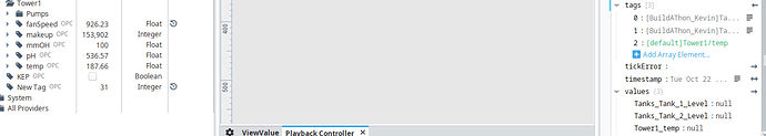

**Author:** ![anitha](https://avatars.discourse-cdn.com/v4/letter/a/a587f6/32.png) [@anitha](https://forum.inductiveautomation.com/u/anitha)\
**Post date:** [October 23, 2019, 11:04am UTC](https://forum.inductiveautomation.com/t/perspective-playback-control-not-showing-values/29275/2 "2019-10-23T11:04:55Z")
![image](https://us1.discourse-cdn.com/inductiveautomation/original/2X/1/145e15643da0a3e51096c9beaaaa6d1745a4dd6f.png)
Attaching image of tags and value object where value is showing null for tag Tower1\_temp.
Could you please help me to get this working?

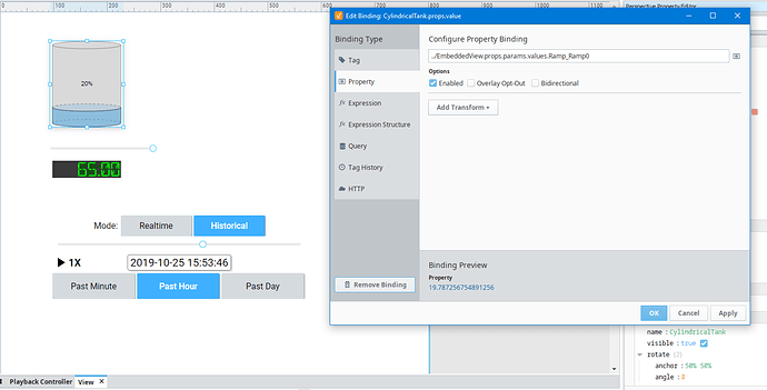

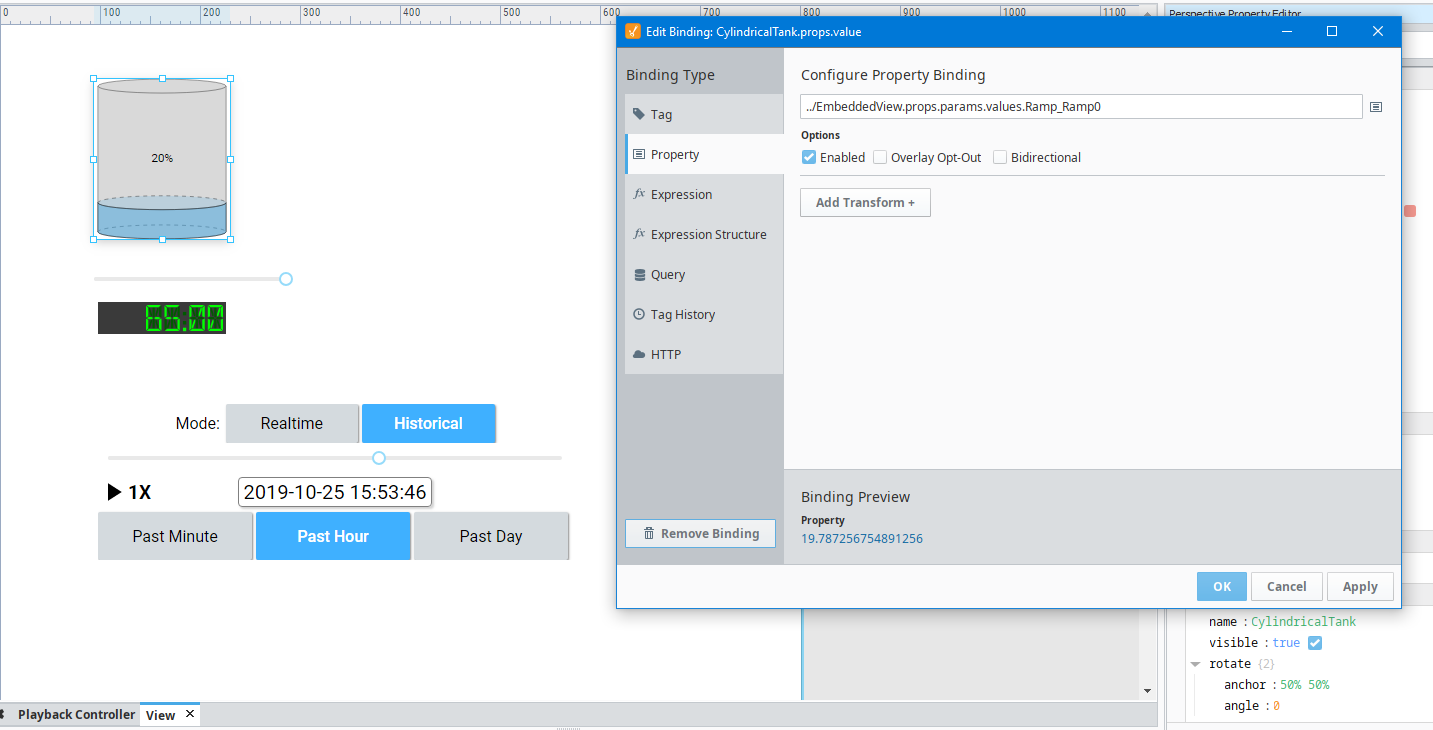

**Author:** ![sjohnson](https://avatars.discourse-cdn.com/v4/letter/s/71c47a/32.png) [@sjohnson](https://forum.inductiveautomation.com/u/sjohnson)\
**Post date:** [October 25, 2019, 11:10pm UTC](https://forum.inductiveautomation.com/t/perspective-playback-control-not-showing-values/29275/3 "2019-10-25T23:10:04Z")
It sounds like your next step would be to drag the Playback Controller onto a view that has some components such as tanks or LED displays. You would then bind the component values to the values exposed under the params section of the embedded Playback Controller.
 ![tagpath](https://us1.discourse-cdn.com/inductiveautomation/original/2X/4/468977610b55e86723c0f84ba9d04d8076a9bcb9.png) ![ExampleSetUp](https://us1.discourse-cdn.com/inductiveautomation/original/2X/a/a13f2dda3ee729e837e647d27eeed788c71ed256.png)
Hope this helps!
**Post date:** [October 28, 2019, 1:50pm UTC](https://forum.inductiveautomation.com/t/perspective-playback-control-not-showing-values/29275/4 "2019-10-28T13:50:08Z")
Thanks a lot Johnson it did help 🙂
I am able to get the values in component and view realtime and historical data.
But the play and pause is not working (i.e., 1X)
