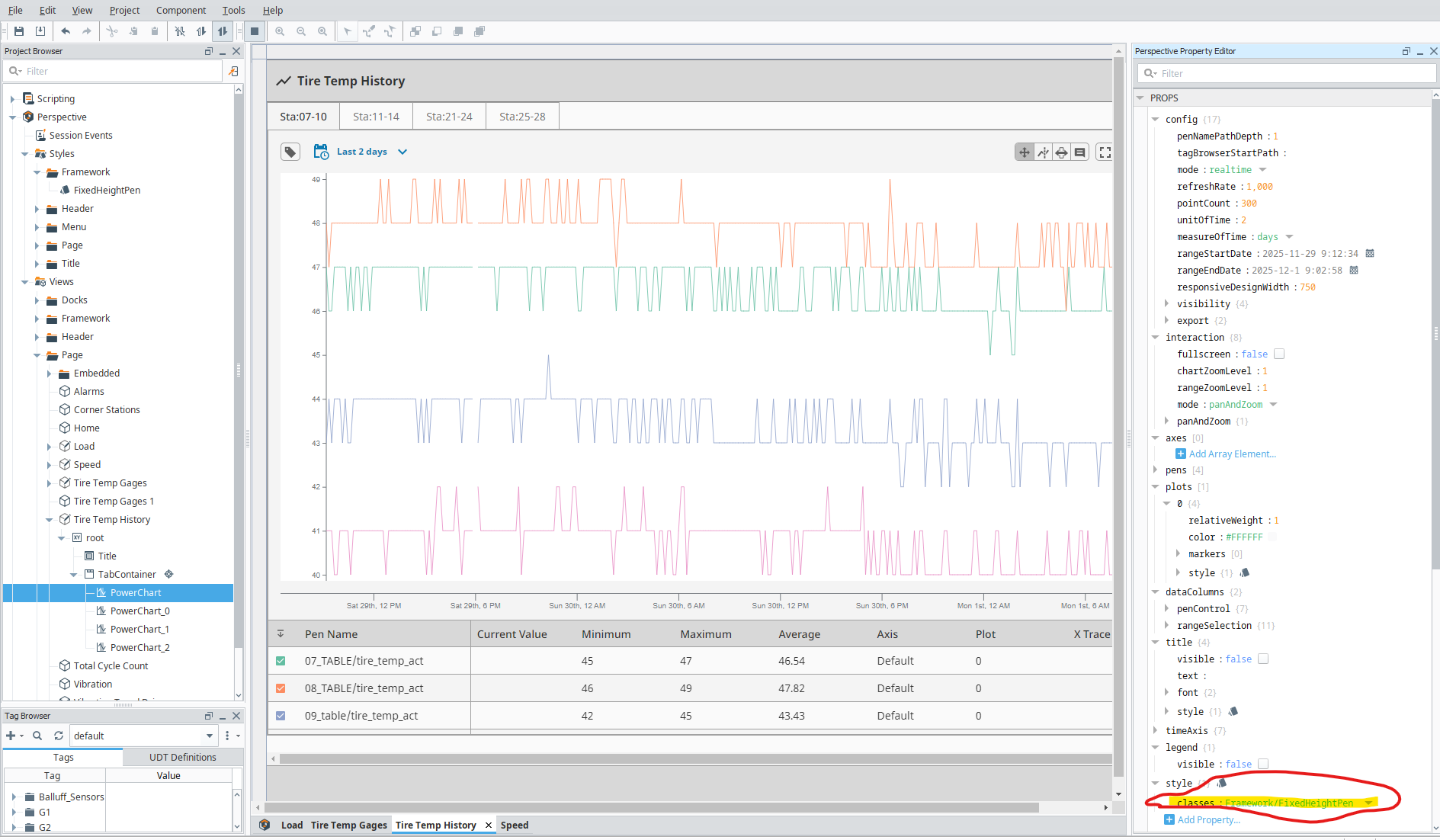

I am trying to implement this style procedure to get my PowerChart graphs to display 4 pens without a slider. I have not done something correctly.
I created a Styles directory Framework and a fixed pen Base Style per the example.
 ![image](https://us1.discourse-cdn.com/inductiveautomation/original/3X/d/9/d954d97d17c0aa30b1fe1c14300c92189ea4a155.png)
I tried to add this to the styles section of the PowerChart and nothing happened
 ![image](https://us1.discourse-cdn.com/inductiveautomation/original/3X/3/4/34c55a6e5bc835273499bdc758f4bf977d258c58.png)
What am I missing?

**Author:** ![PAUL\_SIMMS](https://avatars.discourse-cdn.com/v4/letter/p/3ec8ea/32.png) [@PAUL\_SIMMS](https://forum.inductiveautomation.com/u/PAUL_SIMMS)\
**Post date:** [December 3, 2025, 2:43pm UTC](https://forum.inductiveautomation.com/t/perspective-power-chart-pen-table-height-follow-up/71797/8 "2025-12-03T14:43:32Z")
I am still running 8.1.36.
**Author:** ![jean.arnosti](https://avatars.discourse-cdn.com/v4/letter/j/90db22/32.png) [@jean.arnosti](https://forum.inductiveautomation.com/u/jean.arnosti)\
**Post date:** [December 5, 2025, 7:54pm UTC](https://forum.inductiveautomation.com/t/perspective-power-chart-pen-table-height-follow-up/71797/9 "2025-12-05T19:54:13Z")
Hi Paul,
I have not forgotten you
Seems that I missed something since I posted my solution.
If you still want to have a fixed height for the pen data display at the bottom of the chart, I think the following solution will fit your needs.
The only way to acheive it is to inject CSS using Advanced Styleheet under Styles Subdirectory.
 ![image](https://us1.discourse-cdn.com/inductiveautomation/original/3X/1/5/156940743426e3bdcf1126d9c70f7bbc646c6e25.png)
Once the stylesheet.css enable and opened you will need to type the following
_.ia\_powerChartComponent\_\_penDataDisplay {
max-height: 500px !important;
height: 500px !important;_

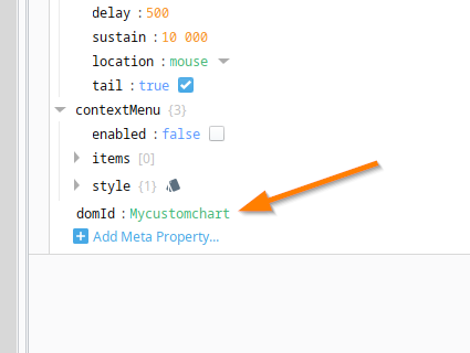

Be carefull this will apply to all your powerChart in your project.
If you want to apply on specific trend you need to add a DOM “Id” in META Properties.
It is hidden by default.
 ![image](https://us1.discourse-cdn.com/inductiveautomation/original/3X/9/a/9a4c0c0a5d6286f074494e8dfd5212f27cd8482b.png)
Give it a name like Mycustomchart or something else
 ![image](https://us1.discourse-cdn.com/inductiveautomation/original/3X/b/f/bfda696205a926d39c871b9f17b8ded9efce59cf.png)
Now in the Advanced stylesheet.css you will need to add this domId value by the following
#Mycustomchart .ia\_powerChartComponent\_\_penDataDisplay {
Hope this will solve your problem
