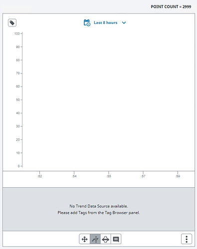

I have a perspective power chart where the operators want to be able to export the data to an excel spreadsheet and see the values at a specific interval. To do this I planned on creating a chart with a fixed time range and point count. But when I changed the point count, the chart wouldn’t load the data.
Here are some examples:
This will never load:
 ![PC-2999](https://us1.discourse-cdn.com/inductiveautomation/original/3X/e/4/e405ae0b9a88c9e91e00d31144f1fc7e4cbb6eb7.png)
This will load fine:
 ![PC-3000](https://us1.discourse-cdn.com/inductiveautomation/original/3X/6/0/60aaf086bdbf43e255bde7ae4bbf6c9632684f16.png)
I’ve done the same test with the following point counts:
2999 = Bad
3000 = Good
3010 = Bad
3500 = Bad
4000 = Good
Are the point counts only allowed to be divisible by 1000?
