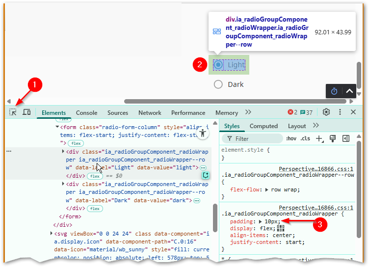

Is there a way to control the spacing between radios?
In column orientation they use a lot of real estate
Thanks
Ross
**Post date:** [October 6, 2025, 11:23am UTC](https://forum.inductiveautomation.com/t/perspective-radio-group/111193/2 "2025-10-06T11:23:51Z")
Here's how to figure it out:
 ![image](https://us1.discourse-cdn.com/inductiveautomation/original/3X/4/c/4c847f7e9904dd6c4a6d5ca9068e864bb0b5334c.png)
- Launch the view in the browser and hit F12 to turn on Developer Tools.
- Use the Inspect Tool (1) and hover around the component until you find the problem. In this case it's the green padding (2) on the radio button.
- In the Styles tab (3), find the padding setting. Here we can see that it's set to 10px.
- Copy that block of CSS and paste it in to Project Browser | Perspective | Styles | Advanced Style Sheet. Edit it down to,
```python
.ia_radioGroupComponent_radioWrapper {
    padding: 10px;
Change the padding to something like 2px and save. It should now update in Designer. If you go back to the browser and Update in the popup you should see the modified layout.
The way this works is that the Advanced Style Sheet loads _after_ the main theme has been loaded. The last loaded of any duplicate style classes is the one that is applied so it overrides the main theme CSS.
