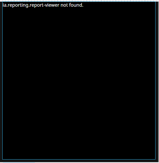

**Author:** ![harigobu.gb](https://avatars.discourse-cdn.com/v4/letter/h/b77776/32.png) [@harigobu.gb](https://forum.inductiveautomation.com/u/harigobu.gb)\
**Post date:** [January 5, 2021, 3:52pm UTC](https://forum.inductiveautomation.com/t/perspective-report-viewer-component-missing/35130/24 "2021-01-05T15:52:36Z")
We are facing this issue. We are in 8.0.15. Are there anything that i can do quickly. because when we are developing we found it was working and now went into production and it got stopped. Early response would be appreciated.
 ![image](https://us1.discourse-cdn.com/inductiveautomation/original/3X/9/d/9dbef8fb9e89f594afc2c3e16e024090fae0c35e.png)
**Author:** ![jball](https://sea1.discourse-cdn.com/inductiveautomation/user_avatar/forum.inductiveautomation.com/jball/32/11128_2.png) [@jball](https://forum.inductiveautomation.com/u/jball)\
**Post date:** [January 5, 2021, 5:01pm UTC](https://forum.inductiveautomation.com/t/perspective-report-viewer-component-missing/35130/25 "2021-01-05T17:01:25Z")
That version definitely has the fix that this original post addressed. Just to rule out an issue with modules, can you verify that the Reporting module is installed in your production environment and in an actively running state? In addition, you’ll want to make sure that the version of the Reporting module is at least 5.0.15.

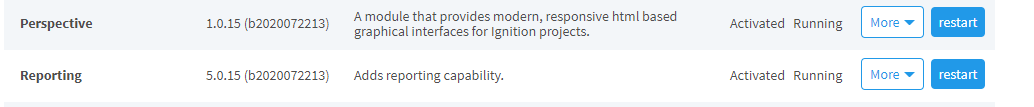

**Post date:** [January 5, 2021, 5:27pm UTC](https://forum.inductiveautomation.com/t/perspective-report-viewer-component-missing/35130/26 "2021-01-05T17:27:57Z")
Hi,
Yes Reporting module is activated and it is in 5.0.15.
 ![image](https://us1.discourse-cdn.com/inductiveautomation/original/3X/f/4/f4c77dd26b5db0a75479fa6674ed88e87c428000.png)
**Post date:** [January 5, 2021, 5:48pm UTC](https://forum.inductiveautomation.com/t/perspective-report-viewer-component-missing/35130/27 "2021-01-05T17:48:59Z")
Sounds good for the Reporting module. Can you also verify your production version of the Perspective module? I was looking at the PR for the fix, and both modules were updated. You should have at least 1.0.15 for Perspective.

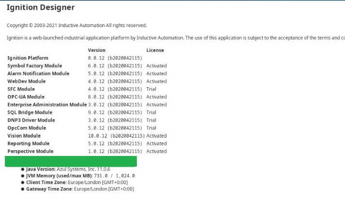

**Author:** ![bnp07786](https://avatars.discourse-cdn.com/v4/letter/b/b77776/32.png) [@bnp07786](https://forum.inductiveautomation.com/u/bnp07786)\
**Post date:** [January 21, 2021, 4:53am UTC](https://forum.inductiveautomation.com/t/perspective-report-viewer-component-missing/35130/33 "2021-01-21T04:53:02Z")
Hi,
I’m facing the same issue,
Report Viewer component is not available in Prespective Component toolbar,
the second issue is, the available report viewer(get from other ignition/demo view), is not updating the value of reports when change the values of bind components.
Perspective Module - 1.0.12
Report Module - 5.0.12
Please suggest on this
Regards,
Bhavin
 ![Ignition Version](https://us1.discourse-cdn.com/inductiveautomation/original/3X/2/b/2b15d0e02d341571132e50bc61fcea23f24227f4.jpeg)
**Post date:** [January 21, 2021, 1:15pm UTC](https://forum.inductiveautomation.com/t/perspective-report-viewer-component-missing/35130/34 "2021-01-21T13:15:24Z")
> [@bnp07786](#):
The fix described above was released in .15. So your version is just too old.
