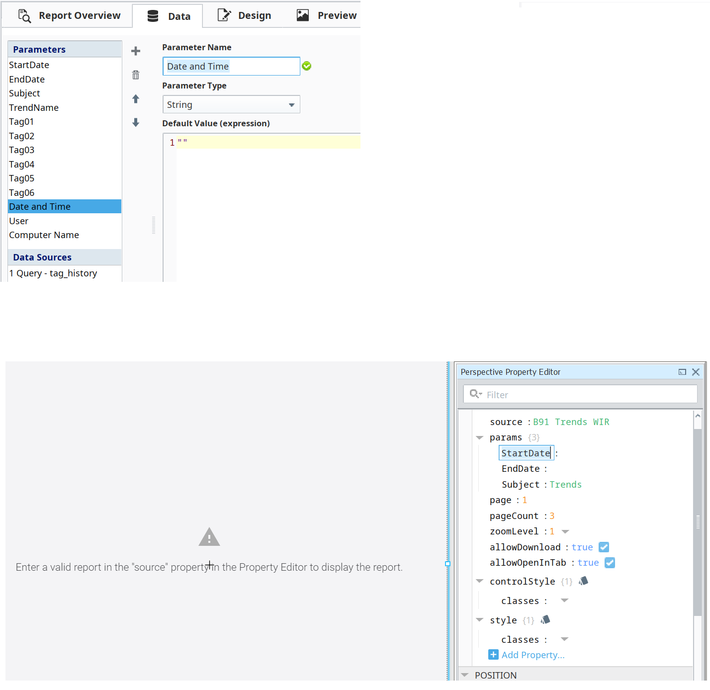

Hi,
So in the report viewer, when I add the param “Subject”, it works fine. however, when I add the param “Computer Name” it does not accept the name (red overlay on the key name).
however, when I add either of StartDate or EndDate, the entire report viewer disappears in error.
 ![1](https://us1.discourse-cdn.com/inductiveautomation/original/2X/6/683bd1e82249044de92426e452797aac60985db5.png)
**Author:** ![jball](https://sea1.discourse-cdn.com/inductiveautomation/user_avatar/forum.inductiveautomation.com/jball/32/11128_2.png) [@jball](https://forum.inductiveautomation.com/u/jball)\
**Post date:** [May 8, 2020, 3:26pm UTC](https://forum.inductiveautomation.com/t/perspective-report-viewer/33138/9 "2020-05-08T15:26:17Z")
Gotcha; thanks for posting the example. Try removing the spaces from any parameter names and see if that clears up the errors.
**Author:** ![melwadeya](https://avatars.discourse-cdn.com/v4/letter/m/ed8c4c/32.png) [@melwadeya](https://forum.inductiveautomation.com/u/melwadeya)\
**Post date:** [May 8, 2020, 3:28pm UTC](https://forum.inductiveautomation.com/t/perspective-report-viewer/33138/10 "2020-05-08T15:28:04Z")
Apparently the report parameters must not have spaces, I changed Computer Name to ComputerName and it is working fine now.
But still cannot figure the error when adding StartDate and EndDate, I get view error as in previously shared screenshot.

**Post date:** [May 8, 2020, 3:43pm UTC](https://forum.inductiveautomation.com/t/perspective-report-viewer/33138/11 "2020-05-08T15:43:38Z")
Thank you, It works now but not for EndDate and StartDate. I need to add them to the report viewer params so that to bind them to date calendar component in a view.
As soon as I add either of them, I get a view error even before attempting to bind anything
**Post date:** [May 8, 2020, 4:21pm UTC](https://forum.inductiveautomation.com/t/perspective-report-viewer/33138/12 "2020-05-08T16:21:08Z")
I’m not sure why the date parameters are erroring out. Can you see any errors in either the browser console or the console in the Designer? Also, can you replicate the failure on a new instance of the report viewer component using only the date parameters?

**Post date:** [May 8, 2020, 7:11pm UTC](https://forum.inductiveautomation.com/t/perspective-report-viewer/33138/13 "2020-05-08T19:11:01Z")
This is strange indeed.
please find screenshots of the designer and browser consoles
is it helping?!
[1|690x222](https://forum.inductiveautomation.com/uploads/short-url/As3Wt7z6uG2fUhiM7PkprGHpK0u.png)
**Post date:** [May 8, 2020, 11:20pm UTC](https://forum.inductiveautomation.com/t/perspective-report-viewer/33138/14 "2020-05-08T23:20:21Z")
Looking back at your component props, the values for `StartDate` and `EndDate` are empty. I would makes sure those are valid `Date` objects and see if that clears up the error.
