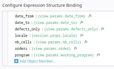

I’m on 8.1.11
I have some cascading views with flexRepeater to group my data.
I have binding with multiple expressions and my problem is that my script fire at each expression change and I want that my script run only once when all values are received for each expression, i have checked the “wait on all” but I can’t figure out how confirm when script can run.
![image](https://us1.discourse-cdn.com/inductiveautomation/original/3X/0/d/0d748ac3abf1bbff0fc0cfa12a9c0e35462e74f0.png)
To get the PROGRAM\_GROUP / PROGRAMS running only once I have added a “flag” to exit id script is currently running.
 ![image](https://us1.discourse-cdn.com/inductiveautomation/original/3X/2/8/28c269337b95208284a3a67ebe835d66645b2a27.png)

GROUP\_ORDER is executed 7x, the only good one is the one with the program 4

IMAGES\_HOT\_SPOT must be executed only once.

Any helps will be appreciated.
**Author:** ![luc.martin](https://avatars.discourse-cdn.com/v4/letter/l/77aa72/32.png) [@luc.martin](https://forum.inductiveautomation.com/u/luc.martin)\
**Post date:** [November 13, 2021, 12:12pm UTC](https://forum.inductiveautomation.com/t/perspective-scripting-binding-firing-issue/52993/2 "2021-11-13T12:12:01Z")
I finally change my approach and now I use sendMessage to pass arguments
