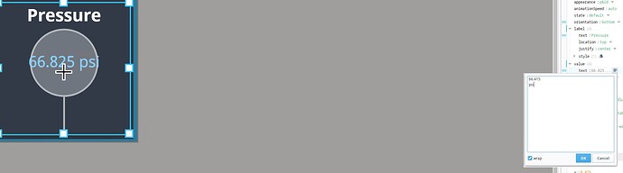

I'd like to create a new line with the units of analog input on the bottom. I've tried expression with '\n' and pre-wrap. The multiline editor shows 2 lines, but the component shows the value as 1. I'd like to avoid creating multiple labels that fit inside the sensor.
 ![Sensor Example](https://us1.discourse-cdn.com/inductiveautomation/original/3X/3/a/3af77de8618cb39f9af8275b5ed79bd156aa6305.jpeg)

What version are you using? I was unable to replicate as the inner label scales with the Symbol:
 ![Screen Shot 2022-10-24 at 12.12.07 PM](https://us1.discourse-cdn.com/inductiveautomation/original/3X/5/5/55300de9f600b24343c541b8c93aa41140b34657.png)
 ![Screen Shot 2022-10-24 at 12.12.15 PM](https://us1.discourse-cdn.com/inductiveautomation/original/3X/3/b/3b7378063681ec3f3a383a480a993a4c0758e650.png)

v8.1.20
I know the inner label scales with the sensor, but I'd like to word break the value into 2 separate lines. Regardless of the size of the sensor. So the unit (psi) would always be on the bottom of the value.
I can do this to labels and labels within buttons by using expression binding with '\n' or triple quotes and adding the white-space: pre-wrap. It seems that the sensor behaves differently. I noticed to change the color of the text I had to modify the Shape/Fill and Shape/Stroke instead of Text Color. That might be the issue with trying to format the value label too.
**Author:** ![victordcq](https://avatars.discourse-cdn.com/v4/letter/v/f6c823/32.png) [@victordcq](https://forum.inductiveautomation.com/u/victordcq)\
**Post date:** [October 25, 2022, 6:54am UTC](https://forum.inductiveautomation.com/t/perspective-sensor-multiline/65607/4 "2022-10-25T06:54:15Z")
text does not wrap in svg's unless using a whole different structure, so i cant help
