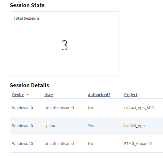

Hello,how can i have access to view how many active session in a specific project like in the status gateway
 ![image](https://us1.discourse-cdn.com/inductiveautomation/original/3X/3/1/311a7f87418ad4aac04a08018823f38691a472f3.png)
**Post date:** [January 7, 2022, 7:06pm UTC](https://forum.inductiveautomation.com/t/perspective-session-count/54781/2 "2022-01-07T19:06:48Z")
[https://docs.inductiveautomation.com/display/DOC81/system.perspective.getSessionInfo](https://docs.inductiveautomation.com/display/DOC81/system.perspective.getSessionInfo)
