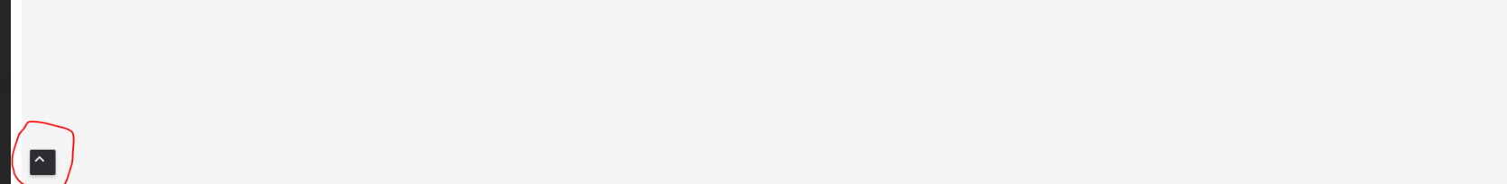

Hi,
can you tell me how to enable this one
 ![image](https://us1.discourse-cdn.com/inductiveautomation/original/3X/2/c/2cc1b4fb38833b8335ee4003d9414b3d77ca0780.png)
we will find the arrow mark when it clicked its shows like this and we can able to logout
 ![image](https://us1.discourse-cdn.com/inductiveautomation/original/3X/0/e/0e26c87350b6087a77b3dad549c730d008310a4c.png)
but suddenly it was not showing for me. How to enable this one?
**Post date:** [February 19, 2024, 9:26am UTC](https://forum.inductiveautomation.com/t/perspective-signout-option/85915/2 "2024-02-19T09:26:25Z")
Project Browser | Perspective, then Perspective Property Editor, check the value for
`session.appBar.togglePosition`.
